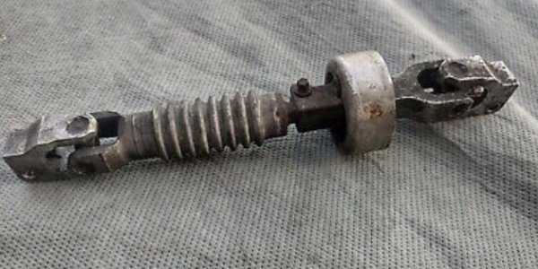

Thanks, I will try that and see if there is a problem with the joint.The steering is slightly heavier than modern fwd, it should not however be stiff.
Jack the front up and cycle lock to lock. If it’s stiff it’s because this
the column steering joint, is in the process of seizing.
Known problem on the e36, don’t bother trying to free the uj’s off, it doesn’t work. If buying a s/h one make sure both uj move freely.
