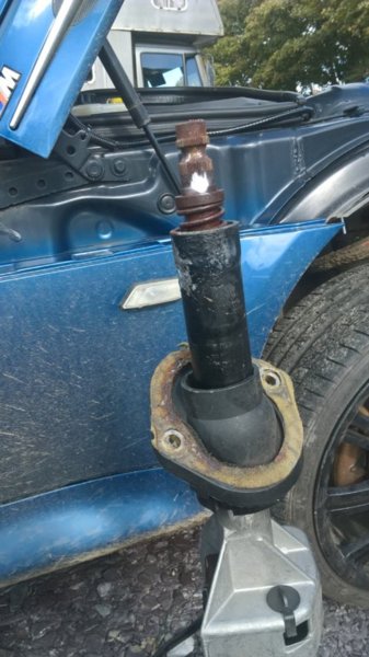

Yep, found it. It's the bottom bush/bearing in the steering column, got the whole lot out and filled it with PlusGas, then let most of it drain back out. Just waiting for a mate to come by and help me fit it all back together, took the bit with the UJs out and gave that a good soak too. Should be a picture of the offending bit somewhere here. The graunching sounds like it's coming from the top of the column, but it definitely ain't. Happy days.:):):)

And for anyone else with this problem that feels like taking out the column to get some grease in the bush, beware. Who the f*** decided to use shear-head bolts to hold the column to the dashboard?:banghead: Can understand using them for the steering lock, anti-theft and all that, but the column? Anyone takes that out they're not going to be driving away with it, are they?:rolleyes:
