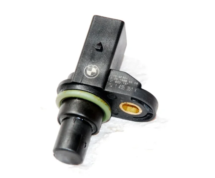

I had a similar set of symptoms a couple of years back, turned out to be 2 things, vacuum leak & Cam angle sensors, As soon as I could see the codes, The members here helped immensely, In that my Z had more than one issue, as I suspect yours does...

If the engine does not turn over sometimes, I think you can rule out clever things such as the cam sensor etc. For the same reason it is also very doubtful if a code reader would be of any use. they are not a panacea for all ills! A code reader may be useful for your stalling problem, but fault diagnosis should start with the simple things, such as checking for splits in the rubber induction bellows between the airflow sensor and the throttle body. An air leak here will prompt a code reader to give an ambiguous message of 'Lambda Voltage Implausable,' which has caused many people to spend £100 each on a pair of new probes - only to find no difference!
On the cam sensor front, I always pull out my exhaust cam sensor at every oil change, and wipe off the accumulation of tiny metallic particles from the probe as a simple preventative measure. The inlet sensor requires removal of the VANOS inlet solenoid, so s a little more involved - I have only done this once.

Sounds like same symptoms my Z3 had when the inlet cam sensor was failing. But best to use a code reader to be honest.

Cam position sensor on it's way out does cause intermittent stalling issues.
