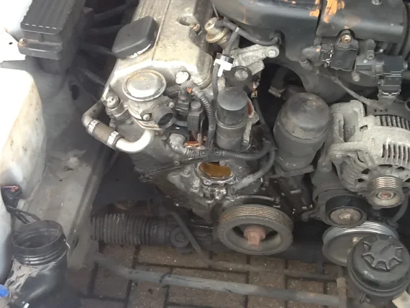

Not a good start on the z noticed water was not going round rad cold got rad off last owner had put rad weld in it pipe at bottom half blocked top one empty so out with the thermostat and snapped 2 bolts not tried to get them out yet then the water pump and it snapped in half in the engine managed to get it all out I think so onwards and upwards just ordered all the parts off eBay cost around £100 hope they fit

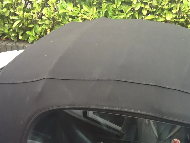

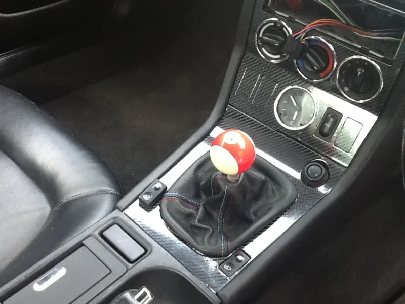

Cleaned the. Mouldy hood came up like new and had a bit of a play inside with 3D Carbon

That's a tad unfortunate, hope all goes well. Interesting gear knob.

A little unfortunate but at least you caught all the issues before major problems.
3D carbon looks good have used it my self on various things on the car, roofs come up nice its all progress :thumbsup:
