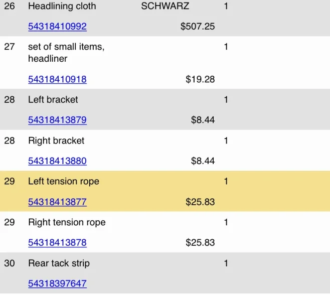

Think these are connected to a roof liner if fitted.

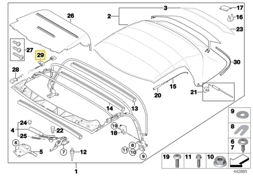

Okay. That's a good start. Does anyone have any images showing where the spring connects to the roof liner?

Pretty sure they connect to a wire that keeps the liner tight when it is folded. I can check on mine at weekend as i dry store mine over winter. Some other members may have puctures.

Yes definitely connected to the roof lining I replaced the two on my car a few months ago.

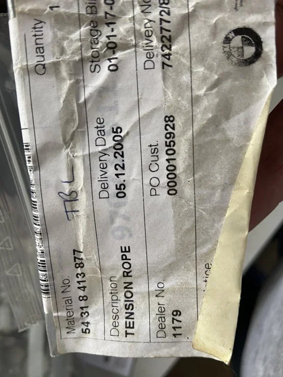

Ive seen posts on here about connecting with fishing line.
If you’re going to use fishing line use braid not monofilament nylon line.

Thanks for all the help with this guys. If someone could post an image showing where the spring fastens to the hood then that would be great. :)
BuxtonZ3Guy
Jan 3, 2022
56
Hi bombur. Thanks for this. I will attempt a fix at the weekend and report back. This is a bloody brilliant forum :)
