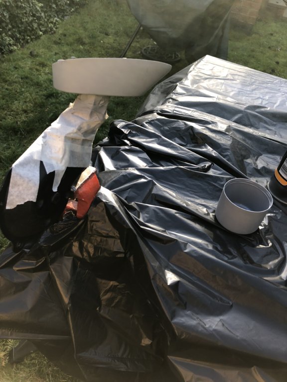

I’ve taken photos so far of where I have got to with spraying the bases of the X8R wing mirrors I’ve bought to combat the corrosion battle. My car is Boston Green so started off very nervous in case I couldn’t match the paint up. Tim kindly offered to fix my errors if it doesn’t go to plan!
After requesting opinions from other lovely members, I decided to give it a go with Halfords' very own paint.
As of this morning I have purchased all the gear from our local Halfords - you know what they say "all the gear, no idea" haha.

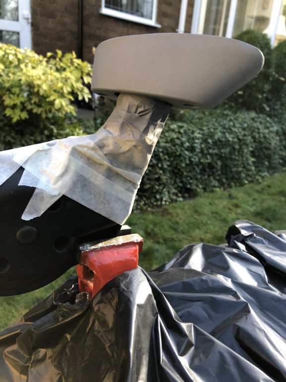

I started off by completely cleaning down all of the new parts using Halfords Paint Preparation Wipes (£1.49 for 5) to ensure there was no dust or debris.

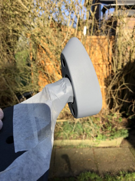

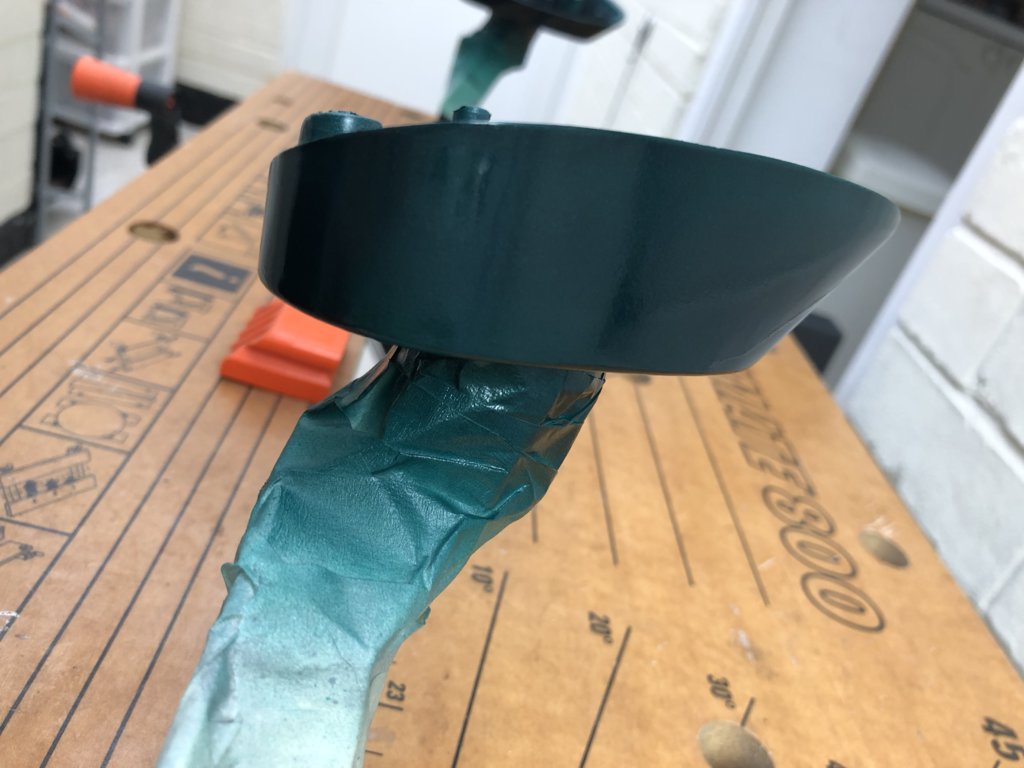

Once dry, I’ve opted for the Etch Primer (£9.99) as recommended on a previous thread. I set myself up outside in the garden as it's a still sunny and surprising warm day for January. I used the primer as instructed on the can - spraying 20-30cm away from the surface in quick even sprays. I opted for 3 coats waiting 10-15 minutes between whilst continually shaking the can whilst I waited.
I'm really happy with the finish at the moment and will attached photos below.
My next step will be applying the Boston Green Paint, when I've done it I will comment below and add further photos!Fingers crossed!

I hate to say this but IMO you have used the wrong primer, etch primer is normally for bare metal surfaces, unless Halfords has one that does both metal and plastic, looks like you have done a great job of applying, what did you use to key the surface.
DanielleHN
Jan 25, 2018
39
Birmingham UK
BMW Z3 2.8i
I read up on all primers Halfords sell and this one states it can be used on a variety surfaces. I also did a bit of googling and it’s come back pretty positive. I’m grateful for everyone’s opinions as you’ve all probably got a lot more experience than myself! There was a comment in the thread yesterday about a success using etch primer so thought I’d give it a blast - hoping it all turns out well.
As the surface was already pretty smooth, I just cleaned it down with warm water followed up by the Halfords prep wipes x

Are you intending wet flatting the primer before top coat?
DanielleHN
Jan 25, 2018
39
Birmingham UK
BMW Z3 2.8i
Hi Tony
I’ve bought the wet and dry abrasive paper just in case but it feels completely smooth to me! There are not lumps or bumps, and the surface feels perfect. I’m going to leave it until Thursday afternoon now as I’m away with work tomorrow, if it’s any different then I’ll probablg gently rub it down
Hi Tony
I know what you're saying here Danielle, but a gloss coat will show up microscopic lumps and bumps that you cannot see, especially on a Matt finish on primer.

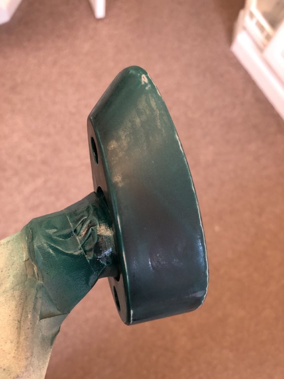

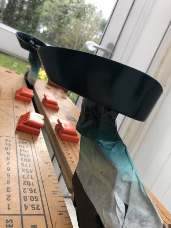

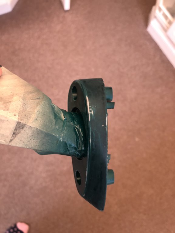

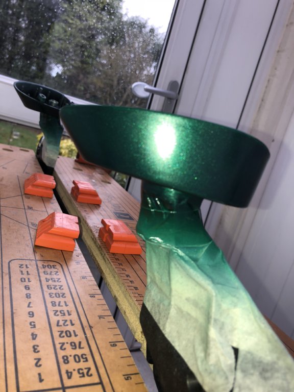

The Etch Primer previously used seem to work perfectly, the surfaces were smooth but took @t-tony 's advice about rubbing down. I used Halfords "Wet and Dry Paper 2500" for the job. I can't remember how much I paid for it but a couple of pound at the most. The paper was a breeze to use and i was really happy with the result.
I set myself up as I did the other day, out in the garden - sun is shining, very little wind and not too cold. As soon as I started spraying the first base, it immediately started to hail - safe to say it b******* the first coat up with drop marks!!! FURIOUS :mad:. However, it's my own fault for risking the British weather.
After I'd finished being livid, had a cup of tea and cracked on with some work (I'm spraying during lunch breaks when working from home), I'd cooled down and was ready to try again. I decided to crack on with the second base - all in all I did 4 coats of the paint Halfords BMW Boston Green (I think it cost about £9). That base turned out perfectly - over the moon.
I went back to the first base and decided to sand down all of the previous paint until it was completely smooth. The Wet and Dry Paper worked a treat doing this too as with conventional sand paper, I would never have got such a smooth finish. 4 coats of paint later and the first base is as good as the second.
I'm made up so far - really impressed with the Halfords paint and also myself for not messing up too badly!
One step left - Lacquer - bit frightened about this so any tips would be massively appreciated!
Photos below including two of the sanded down first base ready for re-painting :)

Same thing applies here after the colour is hardened I would set flat that too, then 3 coats of clear. Wait to harden, wet flat final coat and put in a warm oven or airing cupboard. I don't tell Shirl about that bit.;)
