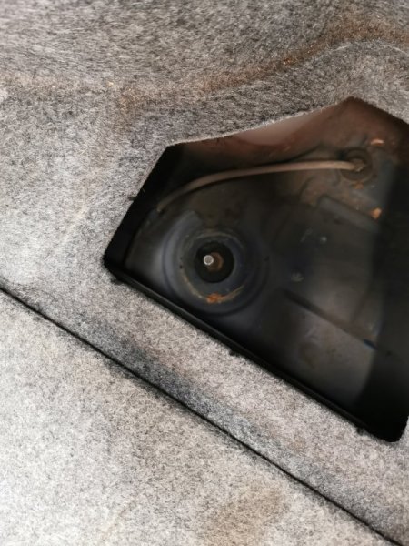

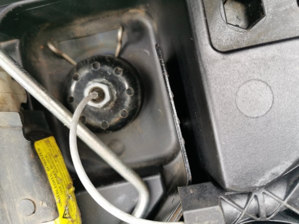

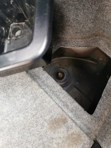

However, I also have a space saver in the garage and fancied installing that in the cage under the Z3 boot - had a go yesterday but it looks like I'm missing a few parts.
I don't have a plastic tray to put the wheel in and I think there is a disc (similar to the one in the tool tray) and bolt missing from being the drivers brake light.
Can anyone confirm and I'd be keen to learn if carrying a space saver is the norm? Cheers.

To answer RickyBobby, yes there is a bolt below the tray behind the light unit which the long plug spanner in the tool kit fits.

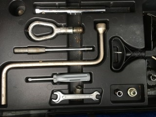

Tha ks - looks like I'm also missing the long plug spanner from the toolkit as well but based on what you've said it sounds like a pointless exercise - I wouldn't want to be leaving the punctured wheel behind so would still need someone to come out. :(

Out of interest what does the supplied fitting too look like - fear I may be missing one of those as well?

A steel bar (Plastic coated one end) that screws into the bolt holes ---normally use 2 then its easy to slide the wheel over them, it holds the wheel in place while other bolts are fitted. Then removed and final bolts fitted. At one time they were standard in BMW kits days of e39 etc. I think the Z3 only has one in tool tray , I keep another one as well, must check they are still there.

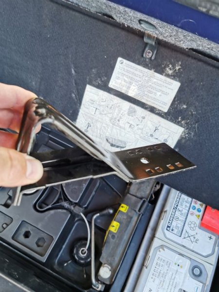

While I've mentioned what I don't seem to have in the tool kit here's something I do have - only problem is I've no idea what to do with it.
Can someone enlighten me? Thanks

That is a wheel chock for when you have to lift it using the car's own jack. My car came to me three years ago with the tool kit complete, and I only have one wheel locating pin. I would love to have two.

I have an idea that it can also be used with the long plug spanner —- never actually used that
