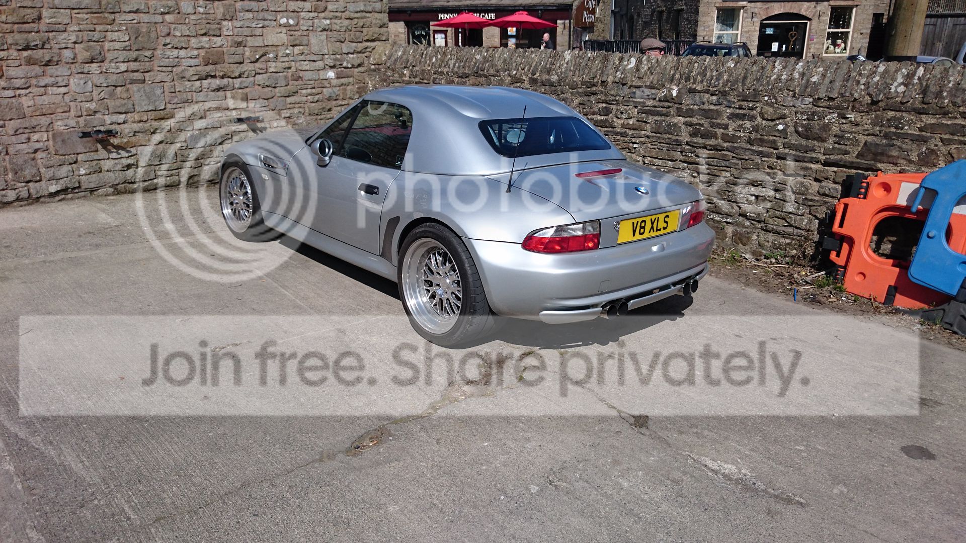

Sell yours and buy @Si Z3 :thumbsup: combo on that is stunning.

It is a proper beast, even better in the flesh :thumbsup:

I can agree was on that run and he just has to touch the throttle and he is a mile further down the road than most folk were in the 3.0s

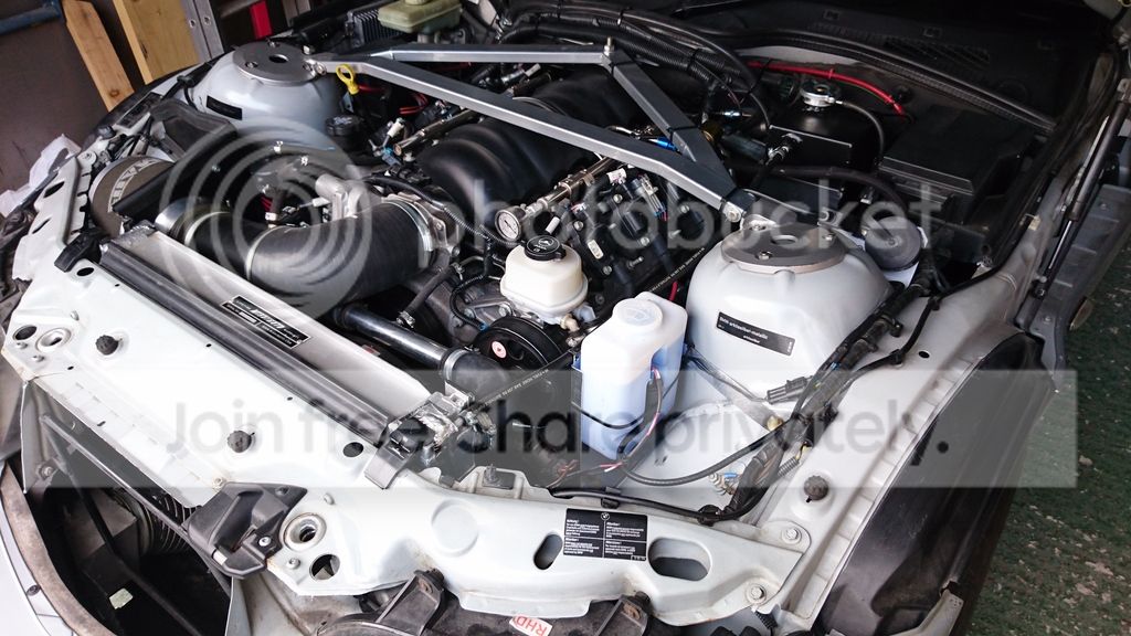

deano1712
Jan 2, 2012
74
Leeds
Z3M
Hey you're talking about me :shy:
If you want more power the advice on buying a faster car is a good one. I went the V8 route and it was a far bigger job than I expected. £12k for the engine installed and then you have to think about upgrading other stuff on the car. Its taken me 5-years to get it running trouble free, confirmed just today with a good trouble free run out. The reward is ace though if you were daft enough to do it lol. I have been considering adding forced induction but that's a thought for the winter months when I have forgotten how quick it is. I think ~550 hp is enough for a zed. There is a guy in aus building a Z3/ LS3 with a charger aiming for 800hp.
If you want tempting the sound during the first few seconds of this video is what its like.
