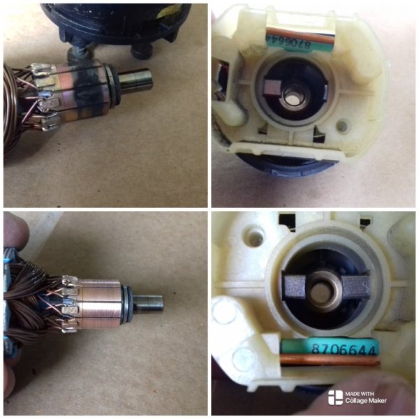

Welcome, I’ve had a few apart, if tapping them, or spraying contact cleaner/WD or similar doesn’t resurrect them they tend to look like this, top two pics.
Takes longer to get the casing off than it does to clean everything. There appear to be two types of brushes, one can be locked in place for reassembly, the other pain in the arse type need to be pulled back individually to get the shaft into the little bush. One of my own motors was so corroded the bush was seized and chewed the plastic housing up. Amazingly it still turned, though slowly and with a great deal of noise. I managed to remove it, polish everything and epoxy it back in place and it works perfectly. So no need to go buying one really, it’ll be fixable.
