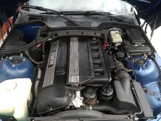

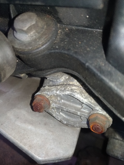

I found out that lot of these codes are related to engine relay or air system (lot of these errors with frequency: 0) that feeds fresh air during cold start. But I cant find relay box neither the air valve - my engine looks like this and there should be air pump feed to the engine but its blinded (next photo)
Anyone has some solution? Where is the air valve or how to solve these errors?

Can't comment on the codes but you say your using M42 script on an M52TU engine?
From the pictures you have no auxiliary air pump system fitted, that's a factory blanking plate and the pump would be where your washer bottle is!
Those relate to the so called smog pump, which as said your car doesn't have.
