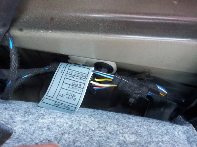

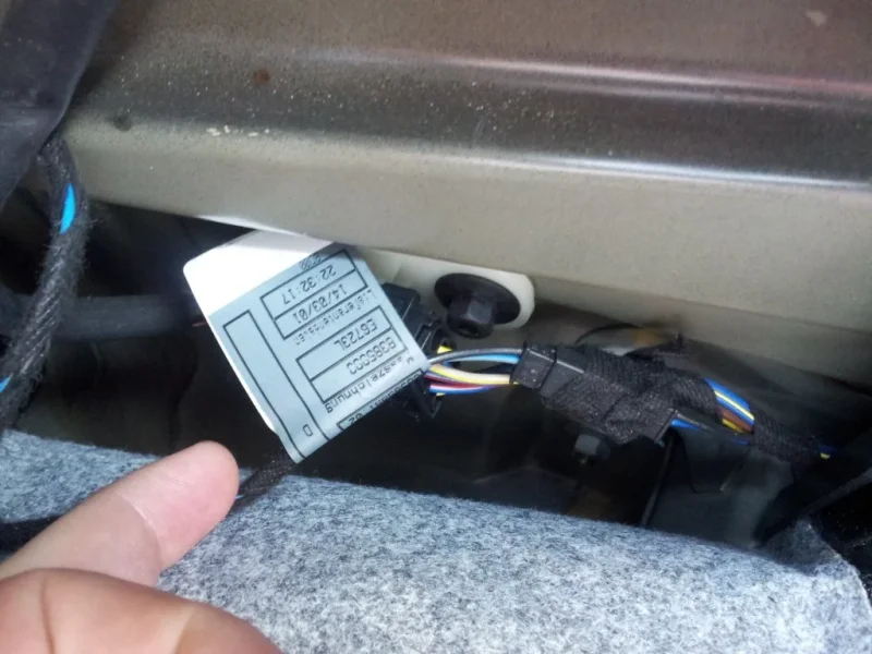

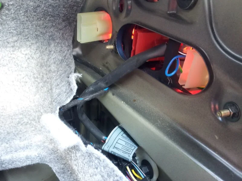

Just been out on the drive and had a look at mine. I have a similar cable which is plugged in to the rear light cluster area. What does it say on your label?

With the info from Gary and Cooper it's sorted. It is the feed for the petrol cap locking solenoid. It was disconnected from the loom where the rear offside light cluster connects to the main loom. Cooper you're on the right track but your photo put me on to it Gaz. In your photo you can see the small plug with the two wires connected to a socket on the loom. Went to have a look at mine, removed the light cover and eased back the carpet and hey presto there was the socket. Connected it up and it all works fine. I wonder why it was disconnected though...

According to the part number on Gaz's it is the wiring harness for the fuel filler cap.
02Wiring set, filler cap104/199961108385991$18.08
Now that was clever @Brian4 - didn't even occur to me to read the label... :facepalm:
