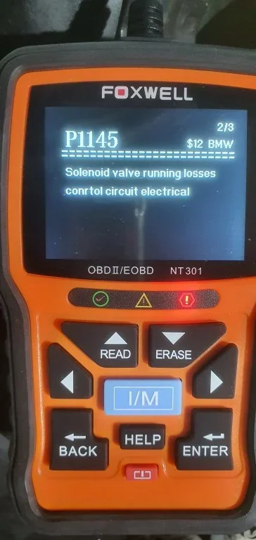

Just got the foxwell codes reader.
I connected it and got several coeds,
one on them was - P1145 – selenoid valve

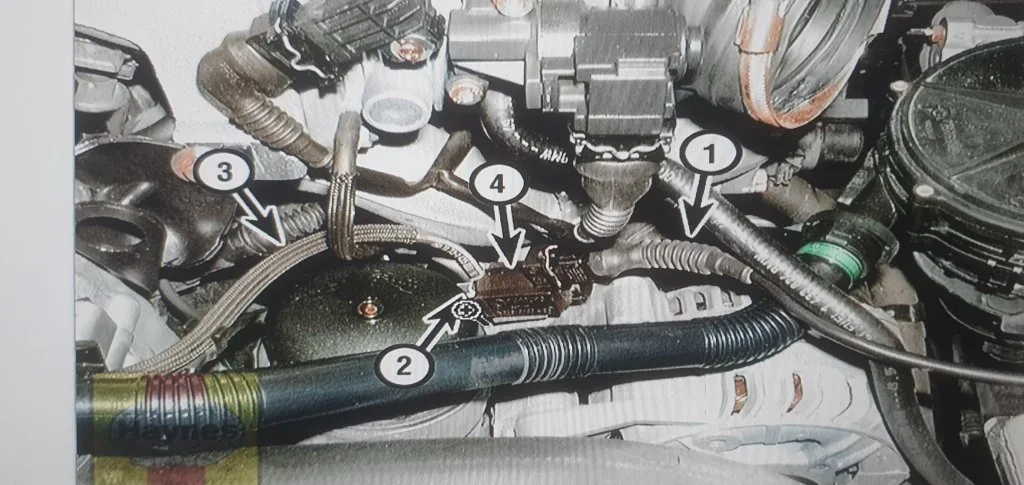

After short research I suspired to find that I do not have this valve – LOL… it's just missing
I attached photo from Haynes book (part number 4 )

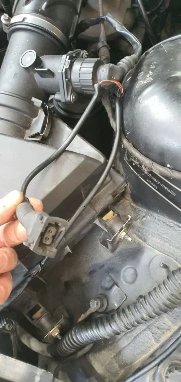

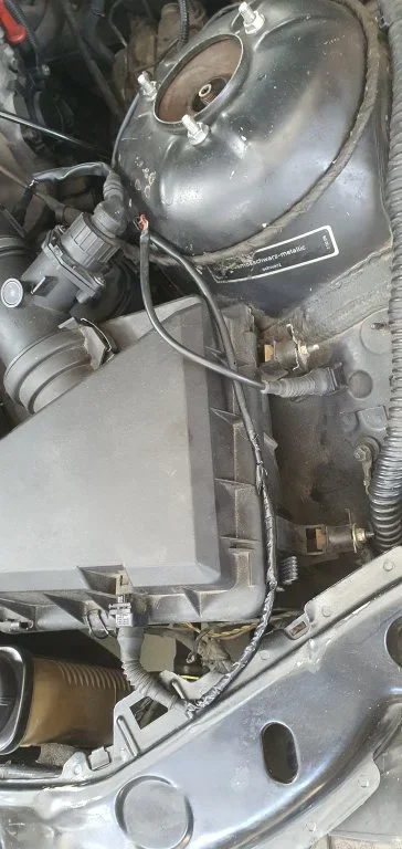

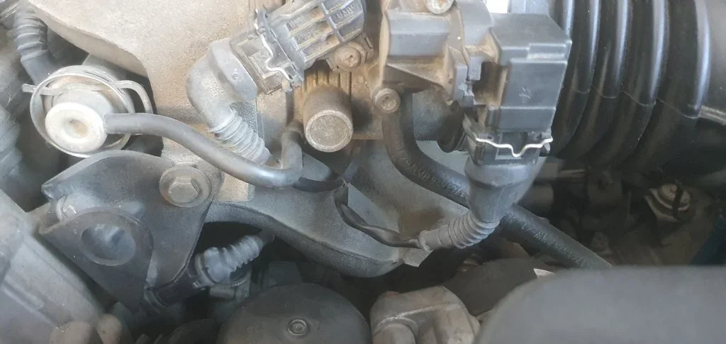

And I attached my engine… nothing there…
Should I have this valve correct ?
If so, I of course will buy this valve,
But I have no idea where I should connect that two tubes ?!

Try clearing the code and see if you get a check engine light after that.
Not sure what that valve does so not sure if you have to have one.

just did and it came back again,
i need to comapre it with somone that have also 1.9 engine...

That solenoid is more for the late SOHC M43 engine. M44's don't have them afaik.
