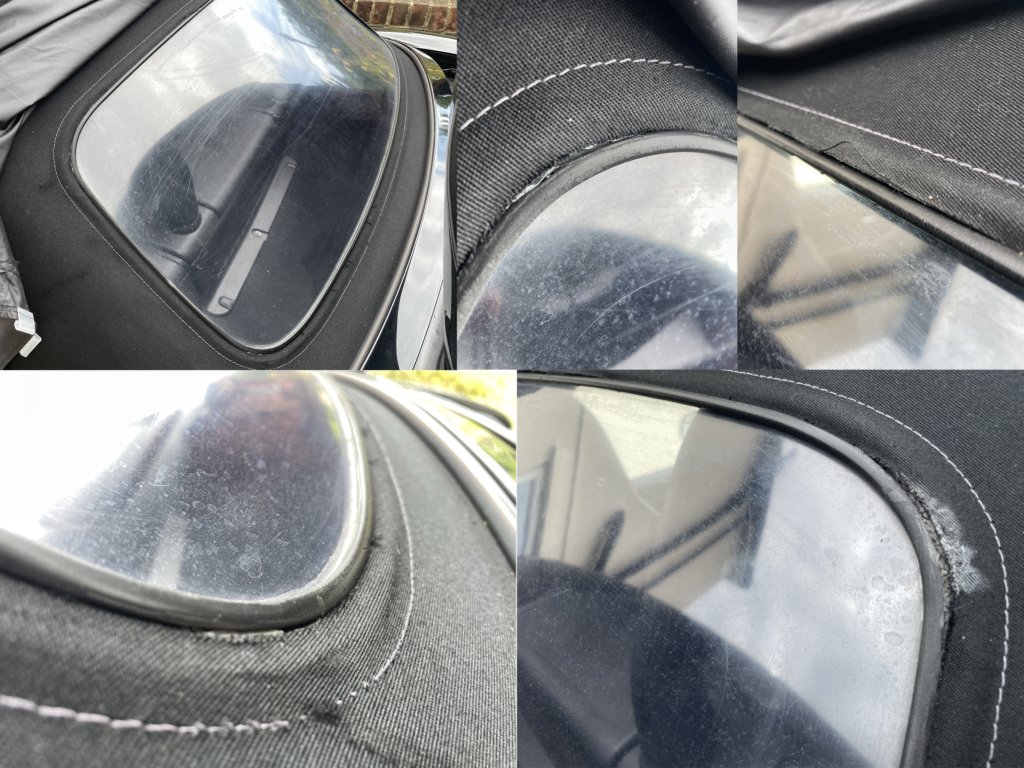

Hi all
I need to get my rear screen replaced as its pulling away from each corner and am assuming its the orginal 2001 plastic.
Looking for recommendations for replacement. Im in Sevenoaks, so ideally somewhere south east or an hour or two from me would be great.
Thanks

Check carefully before getting too worried about that. Mine looks much worse than yours but is still watertight.
inkey$
Mar 27, 2014
95
Kent & Suffolk
'01 2.2i M54
Thanks. Yes, its watertight. Just looks horrific! Plus good opportunity to get a shiny clear rear screen.
AntStark
May 15, 2021
139
Hampshire
2002 3.0 Sport
Notice your stitching that holds the zip has started to rot and perish. ..see the missing threads..that’s what started mine leaking not the plastic screen
inkey$
Mar 27, 2014
95
Kent & Suffolk
'01 2.2i M54
Yes, I might need to break out the needle and thread too.

For what it would cost to get a new rear screen fitted plus looking at the photos of the hood I'd just bite the bullet and take a trip to Swansea
inkey$
Mar 27, 2014
95
Kent & Suffolk
'01 2.2i M54
Its £120 for a new screen to be fitted and the rest of the hood is in pretty good shape.
How much is a new top in Swansea?
Ade33
Aug 20, 2022
56
Stratford upon Avon
3.0 Sports Edition
Fair enough..When I was looking the minimum cost I could find was £200 to fit a rear screen..Given that my hood was 22 years old I decided to invest £400 at Jack Smiths and very happy with what he has done.

I replaced my back window quite a few years ago. The new one zipped in good but that flap of material still didn't tuck under the piping/bead.
So even if you so zip a new window in you'll have a nice clear window but don't expect it to solve your problem with that flap of material.
A new roof often comes with stitched in window. Not zipped in. So you won't have that problem with the flap of material.
inkey$
Mar 27, 2014
95
Kent & Suffolk
'01 2.2i M54
There must be a simple way of reseating/sticking the flap back under the piping.
Duncodin
Sep 8, 2021
139
Pontrhydyrun
Z3 M44
People do use adhesive. With a thin nozzle they feed it under the piping and then push the fabric flap in. I didn't try though. My flap just didn't have enough material to tuck it in all the way round.
That was around 10 years ago that I replaced the window. Took it out again last year but when I tried to zip it back in much of the stitching just broke. Totally rotten.
I'm in the process of replacing my roof now. On taking it out so much of the material is ripe and just crumbles. I meantion that because if your roof is nigh on 25 years old I think you have a choice.
(1) don't fiddle too much. Accept that it's an old car and just enjoy the car with the roof as it is.
(2) fit a new roof.
