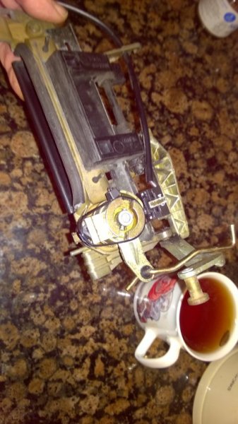

For some time now I've had to give the door a bit of a thump while lifting the handle to get the door open from the outside. Inner handle opens it no problems, so that narrows it down a bit. The door lock has been messing about, too, it's fine on the central locking fob, but the alarm is a bit too sensitive, every time a big tractor (rural life, eh?) or a noisy motorbike goes by too close the alarm goes off. Since there doesn't seem to be any sensitivity adjustment (unless anyone else knows different) and I don't want to pi55 off the neighbours any more than is strictly necessary I've been locking it with the key. Now the barrel just goes round without doing anything so it's time to get out there and start swearing. Qualified mechanic, you see, so plenty of swearing.

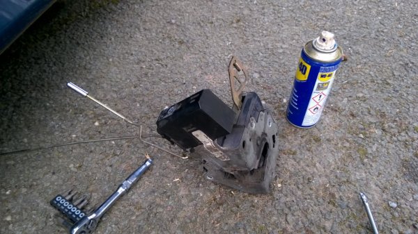

Anyway, this comes out
and gets attacked by some WD40 (other, better, lubricants exist but this'll do) and then this comes out after getting a bit swearier, notice the key slot, ain't meant to point that way

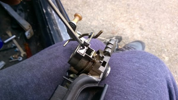

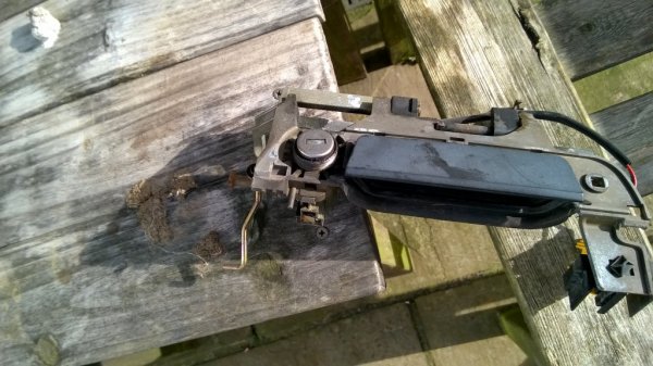

had a fiddle and worked out what was wrong. At the end of the screwdriver there should be some kind of retainer for a little springy thing
but it's gone, nothing rattling around in the bottom of the door, so it's off to make something soon. Got a cup of tea to finish first.:thumbsup: If that doesn't work I may be calling on the help of some of our worthy Z dismantlers, but should be able to bodge something together.:whistle:

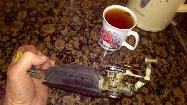

Well, that didn't take too long. As quick bodges often don't.
Note the approved Bad Obsession style cup of tea.
And the careful use of a cable tie to prevent something from moving. It works, and that's what matters. Seems to be some kind of storm happening outside so I'll leave refitting it till tomorrow.;)

Builders tea looks a little on the weak side :yuck: oh yes, good bit of bodging by the way :thumbsup:
