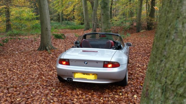

    I used some that tinting film. You can make it dark as you like by adding more layers. Cheap as chips

    Thanks for posting up the pic. Great to find reference. Looks good. The kinda shade im looking for. Is there any noticeable seams on the lights or does it disappear from a few feet away?
    May i assume for MOT purposes that that must be white reversing lights, Red brake lights and orange indicators? Is there a scale of whats considered orange? :bag:

    As far as an mot goes basing it on the all red light look
    Side lights as long as light output not seriously reduced be ok ( as obviously colour will be right as red lense)
    Stop lamps again same criteria.
    Reverse lamp NOT part of mot for that age of car before 2009 ( police may not be happy if they see the reverse lamp in action but that's a different part of the road traffic act )
    Indicator. This is the potential problem one as it must show amber ( how orange is to a degree slightly flexible) for example I regularly advise and fail amber bulbs kn ear lenses for incorrect colour ( too white ) so really depends on how amber they look if they look reddish will fall example of that would be American cars with red lenses and red flashing turn signals if uk imported gave to be converted ( quite often with amber led units cut into bumper )
