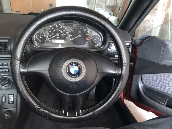

My 1999 Z3 has a sports wheel with damage to the cover and the spokes. There are lots of wheels on eBay etc but with the 4 way connector whereas mine is a 6 pin one. So if I buy a 4 pin fitted wheel can I swap slip rings or am I basically stuffed?

All the wiring and slip ring is separate from the wheel, so you just transfer it to the new wheel.
Get it recovered by Royal and repaint the spoke cover? Here’s mine
