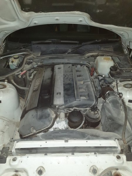

Feb 20, 2015
2.8 Roadster
🤣🤣 Showing my inexperience.. I didn't know there was an under bonnet one? I'll have a laugh tomorrow trying to work out where that is....
You need a 21 pin connector (I think that's the right amount.
The small round connector cap ringed.
Edit. Yours is a 2.2 and newer so location may differ.
Feb 20, 2015
2.8 Roadster
A very nice clean engine... Mine looks like a desert tent find at the moment 🤣🤣
Will check tomorrow... it's 1030pm here at the moment and the mosquitoes are very hungry 🤣🤣
:thumbsup:

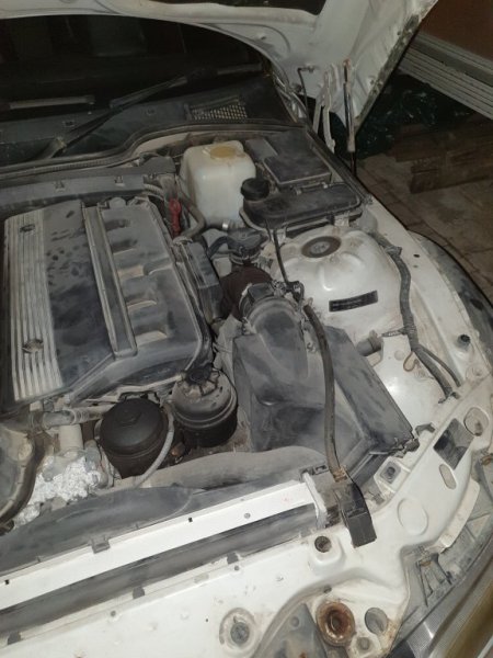

Feb 20, 2015
2.8 Roadster
Try here mate.
Oh, I've just had a heart attack, I'm on my way with my Autoglym kit =)) :detailing:
Steve D
Jan 2, 2023
23
Try here mate.
Hey Andy, thanks for the tip. Found it today so just need to get a 20 pin to 16 pin adapter at the weekend. Hopefully it'll reveal a bit more of why she won't start. If not, I think I'll start at the cam inlet sensor and work my way round. Maybe even give it a shine on my way through.
