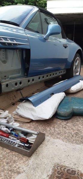

It's time for new outer sills. Took mine off today with the hopes of home restoration, but one is just too far gone.
Has anyone had a new set of sills painted recently? Is so, how much did the paint shop charge

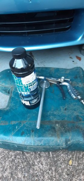

I had mine repainted by a pal at work 5 years ago in return for a selection of fine local ales. One original sill was in good shape and was reused, one was a new BMW replacement.
I supplied the Atlanta Blau paint which was expertly matched by All Parts Exeter. I used Gravitex stone chip on the new sill. It looks spot on.
My top tip would be to apply corrosion prevention compound on the inside face of both sills and inner box sections while the sills are off.
