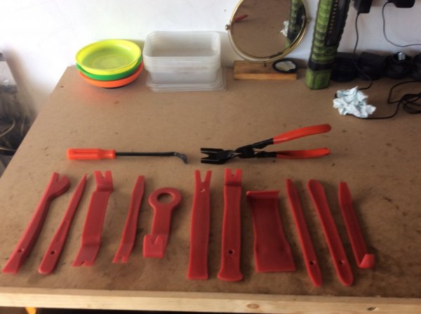

The side gills have 1 screw and five plastic push fit clips on each side.
Undo the screw and use a plastic pry tool ( preferably one with a 90 degree bend so you lever them) to ease them out and should be fine.
Any with the bend will be ok, it just gives a bit of pressure
