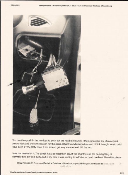

Following on re replacement of light switch, how does the small light fitting (the one connected with two wires) fit in. I just cant make it stay in place. Pic attached (not a good one - sorry) where i have tried to show the mini lamp. Look mid left of page, tried to mark the print out.
There is a video on YouTube which shows how to do this. I’ll find it later and post you a link.
Thank you Tony. Put it back together now without light - Not screwed the screw in either - one in there came out to easy. Do you know what size screw holds in the light unit in place? (I will pop to halfords and buy a pack then)
I’m fairly sure the nut is 8mm.

Sorry i did not explain myself very well. The one you screw on when chrome knob off - that screws in to the car frame to hold unit in place.
