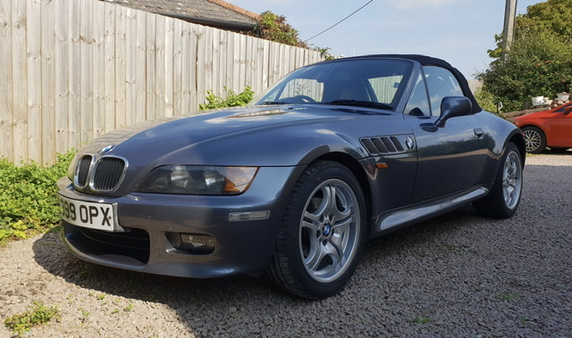

I had 20mm on rear and 14mm on front on my Z3. These are now on my Z4. I'll dig some pictures of the Z3 out later if I can find them.

This is 20mm on the rear of mine, I don't have any on the front.

Sport suspension with 20mm on the rear, none on the front...

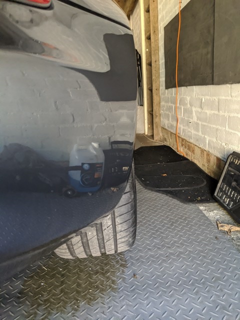

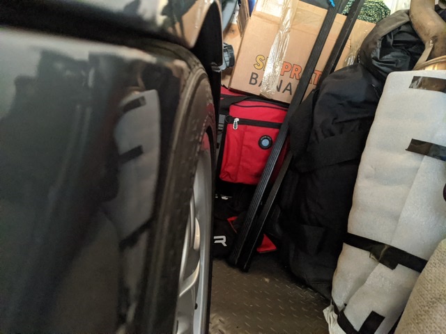

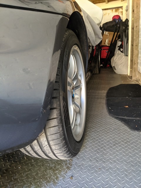

Took some pictures today of my current setup, before lowering springs and spacers.
Style 68 wheels and the fronts are actually not as set in as much as I thought. So +10mm on the front might be the max I’d want to go.
The rears on the other hand, have masses of mm’s to go before being near to the arch overhang level.
