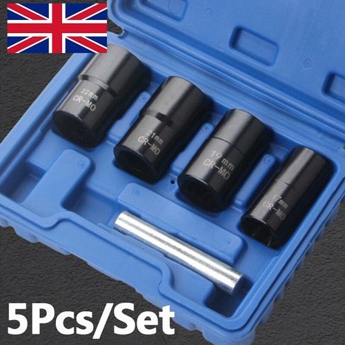

Just bought a set of Extractor Sockets that have spiral flutes inside that bite into the flats the more force you apply to undo the sensor. I already had a smaller set but the sensors flats are 22mm my set only went up to 19mm. Got mine from Amazon but they are available on ebay at a cheaper price. Will have to cut off the top of the duff sensor to get the Extractor socket on its flats but as its dead thats not going to be a problem.
Should be able to get a breaker bar on it to exert a good amount of force on it to get it turning. Space is tight but hopeful I can get enough swing to start it moving. Will apply some heat from my Map Gas Blowlamp as well which should assist. Will report back on how these extractors perform.

Another afternoon spent on getting the duff post cat sensor out, had a go at sawing the top of the sensor off with my reciprocating saw, that managed to put a slot a quarter of the way through it then no more despite changing saw blades twice, no room for an angle grinder to get at it so had a think and decided to use the air hammer with a flat chisel in it. Put the chisel in the slot the saw left and pulled the trigger. After a few blows it gave up and parted itself from the hex fitting at the base. Now it was preety rounded off from all the previous attempts to get it out so hammered the new 22mm Extractor socket onto what was left of the Hex and got a long breaker bar on it, just enough room to get the breaker bar in. A good pull on the breaker bar and low and behold I hear a crack reposition the breaker bar and give it another pull and yes the hex is unscrewing. Quick douse of penitrating spray and continue unscrewing it, well impressed with the bite these extractor sockets exert on a rounded off hex. At last its out, ran a thread chaser down the hole to ensure the threads were clean then screwed the replacement sensor in by hand followed by using a good fitting 7/16 open end spanner between the two exhaust pipes to complete the install and finally tigten it home. Ran the sensor wire up to the top of the engine and connected it to its plug under the beauty cover.
Cleared up the array of tools I had amassed and started the car, quick check underneath for any leaks then broke the Launch Scanner out to monitor the sensors. Clean bill of health all sensors performing as they should what a relief.
Pictures show air hammer chisel and its victim, dead Sensor remains and new Sensor installed.
I would advise owners to bolster their toolbox's with a set of those Extractor Sockets for times like this they are far better than the standard cut-away Lambda Sensor sockets which slip and round off the Hex, the only downside being you have to cut the old sensor down to get them on, not seen any deep extractor sockets on offer so far. Be warned hacksaws powered or not struggle to cut through these sensors, air hammer and chisel is the way to go.
