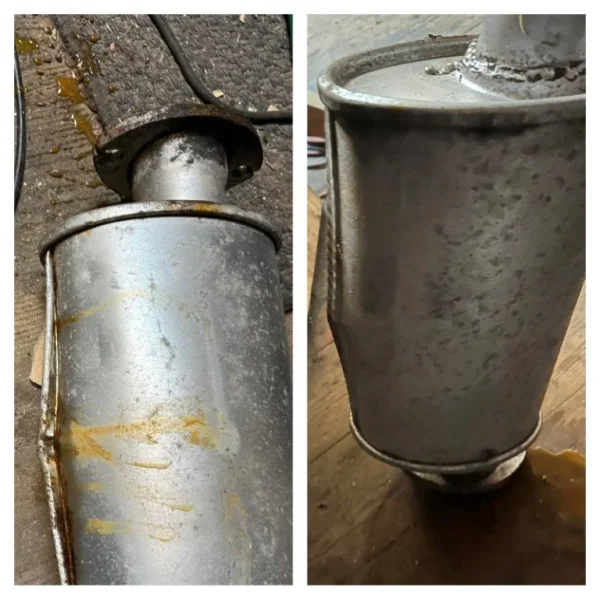

A decent look at the rear exhaust quickly showed it’s not worth refitting. Both boxes were already cracked and welded, the pipe had needed a repair. Now the intermediate box is split. And it’s absolutely full of water. ?
Now I could smack the box together and reinforce with weld. But I just can’t see it lasting.
If I’m fitting another exhaust it’s going to be stainless.

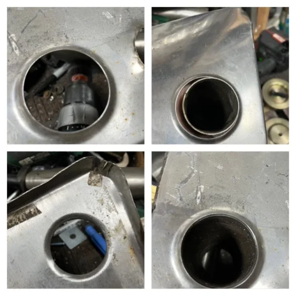

I have enough for 4 end plates, so, 1 practice, 2 proper and one saviour if I feck anything up.
Problem 1 immediately apparent, it’s Really Hard, I was going to wreck the faces of my planishing hammers, switched to the ballpein. Problem 2, it doesn’t shrink like steel does, I battered and battered and battered the corners, but they simply would not fold and shrink. I’m sure the neighbours loved it. Resorted to experimenting with slitting it. It works, I now have a plan for a couple of little experimental pieces.
Really serious problem 3, you can’t stretch and cut the stuff with a dimple die. It should cut a disc out and form a dimpled flange. It warped to Friar Tuck.
Cutting a hole, then dimple die’ing, stretches the plate enough the pipe doesn’t fit. My next smallest die is 44.5mm and I want to use 50.8mm tube, will it work? Well, almost, there isn’t much in it, I should be able to cut that back to get a nice fit.
Further experimentation required, but I think I can get this to work out. Should end up straight through, no back pressure except the cat and yet quiet. I have a stupid plan for the shotgun tailpipes too!

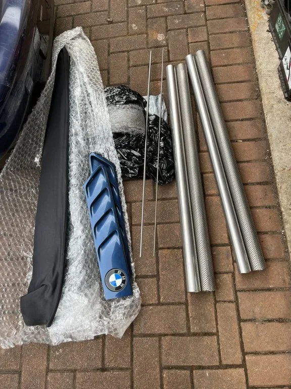

Lots of bits arrived, special thanks to Andy, spurs fan in a coupe for the headliner and vents.

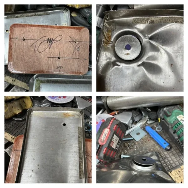

19FCF950-0C0C-440F-9FEA-C18E9E98A81C.jpegAttacked the exhaust endplates with a vengeance, dear god stainless is hard. I hammered and hammered until I was knackered and still only formed one corner. No pics, because I’m not that happy with it. I actually phoned all the local industrial places to see if anyone had a shrinker/stretcher in stock. That’s all gone on the back burner though, depends on what happens Mini wise.

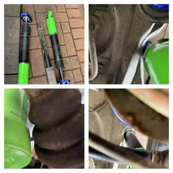

I had these eBay dampers taking up space. Pulled the Boge and stuck these on, partly to make space and to check they actually fit.
Which they do..Just. I was considering going full coilover, but that would require offset top mounts.

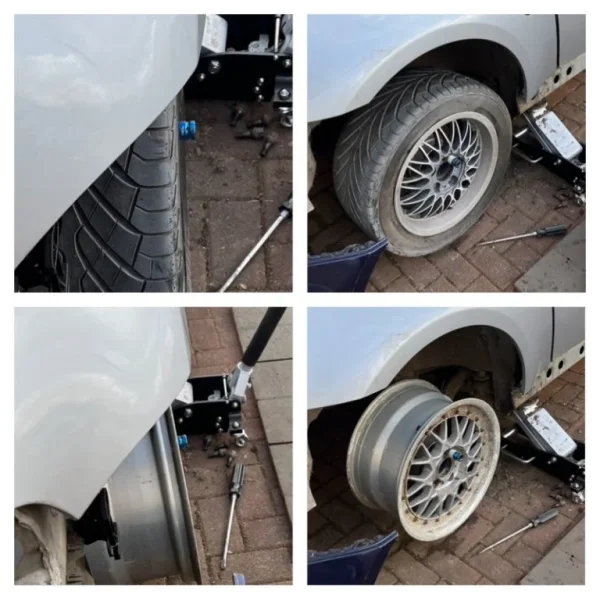

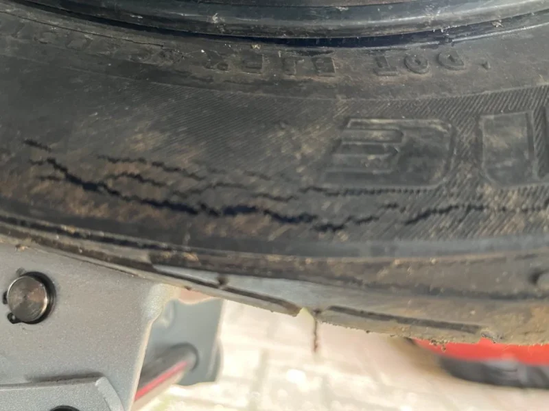

Jacking the wheel up to refit the damper I found a huge crack in the tyre, it was slightly down in pressure, the jack distorted it which probably made it more visible. I expect it’s sat flat for some time in the past, I’ve just been lucky to jack it in the same place. Scrap.

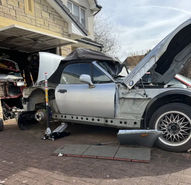

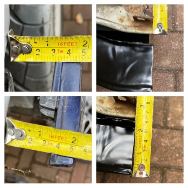

As I was about to pull the rear wings off to do the sills and fit the wider ones, I thought I’d measure how wide they actually were.
Certainly not the 25mm someone assured me.

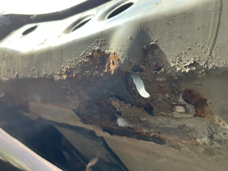

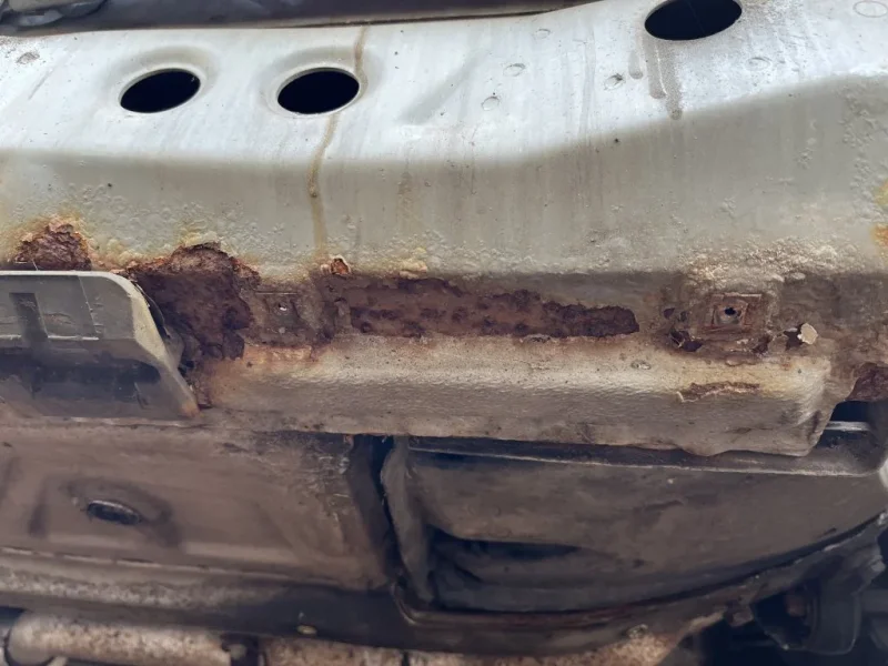

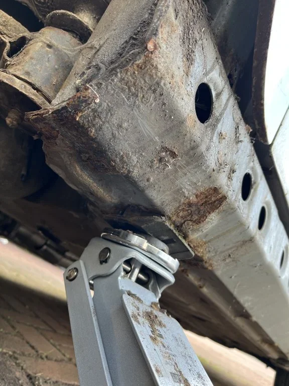

I was quite eager to find out how bad the inner sill was on the left side, I could see a tiny hole at the rear.
Not that bad really, I expected half of it to be missing.
The front is rusty but solid.
Wire brush in a grinder, there’s a repair required right at the rear. All heavily pitted but solid when smacked with a hammer. Wiggling a finger inside reveals no rust on the inner metal except where it’s holed.
Im unsure whether to just repair the holes areas, or cut the whole thing back to that square hole on the left.
At that point rain stopped play, I have a few days off this week to do both sills and drop the beam, and what’s the Forecast? Snow. Wonderful.

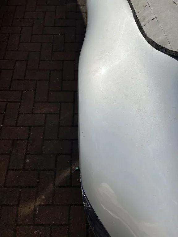

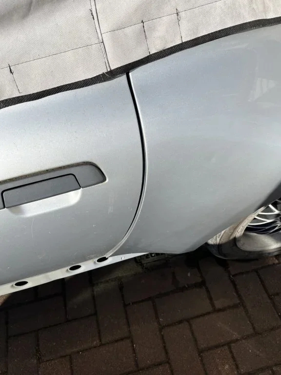

Dragged the wide rear wings I got from Andy, spurs fan in a coupe, last year , out of the loft. Titan rather than Arctic, but it’s not far off. I need to find my spot weld drill bits and get the brackets off, it would be quite difficult to sort the back of them properly with the brackets in place.
It’s certainly, absolutely, definitely not a 25mm difference between wide and narrow body. It’s 50mm. Each side. I need wider wheels. Even with spacers, I need wider wheels. Bugger. I have some 8.5” RC’s, though one barrel is cracked, oh dear.

Right sill has some rusty bits, just surface really, a quick clean and I could prime it with Finnegans.

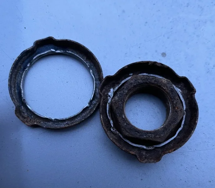

I’d forgotten to release the axle nuts, thankfully I remembered before disconnecting the handbrake cables. I really don’t like those lock washers BMW use, they lock well, but bending the things back and getting them out is a faff I don’t enjoy. I have a spare 30mm socket I’ve ground the lip off, so the teeth are flush to the end. I find if I smash the socket on with a bfh it crushes the lip of the washer flat. A five foot piece of box section over a breaker bar and it’s easy peezy.

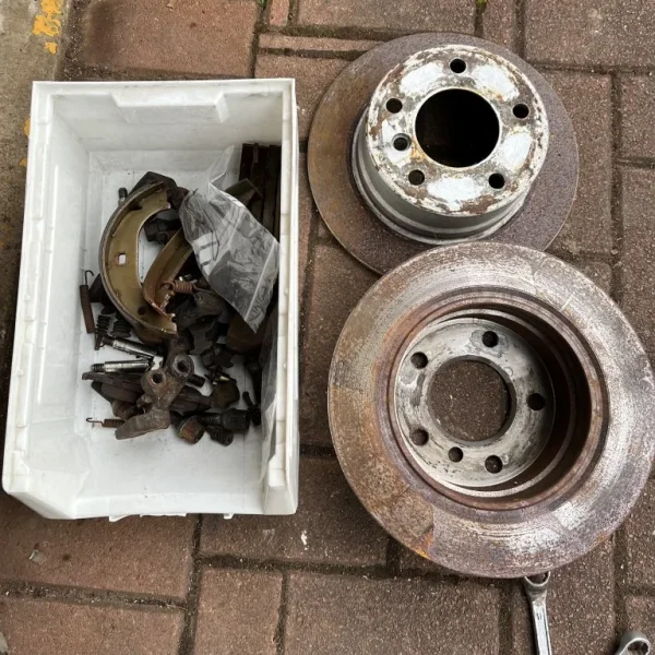

Stripped the rear brakes whilst I have easy access.
I’ll reuse the pads and shoes, the car only did 2000 miles and 1000 of that was M way down to Hemel and back. I may use the discs if I can’t find the Fancy Dan ones I have . . Somewhere. That’s only surface rust, a zap with the random orbit and they’ll be good as new. Re clean the hardware. Totally strip and redo the calipers, I’d cleaned them before but this time I’ll replace the pistons.

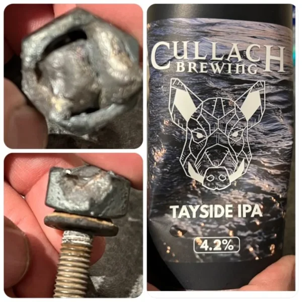

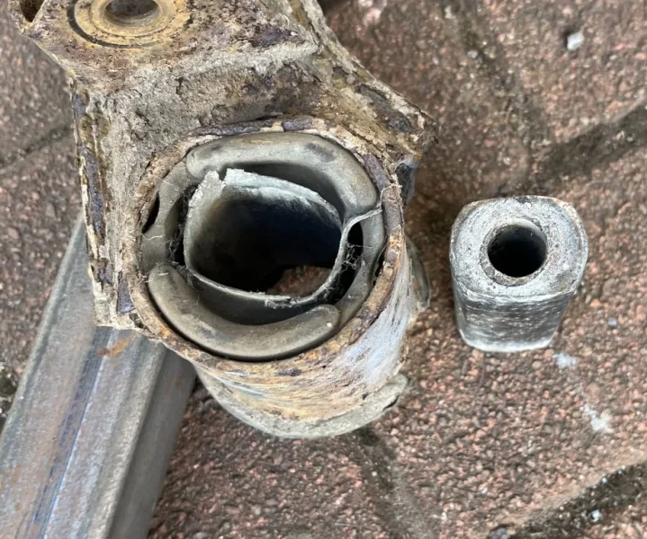

The Bolts of Doom? Yeh, they’re feckin’ “doomed, doomed ah tell ye!” Sprayed, battered, sprayed on the inside, stripped, battered. Chewed with an extractor. I’ve gotten one out by heating the hell out of it, then smashing a smaller extractor on.
At that point the sun dropped past the hills and the temperature dropped dramatically. Sprayed the remainder, I’ll heat them in the morning.

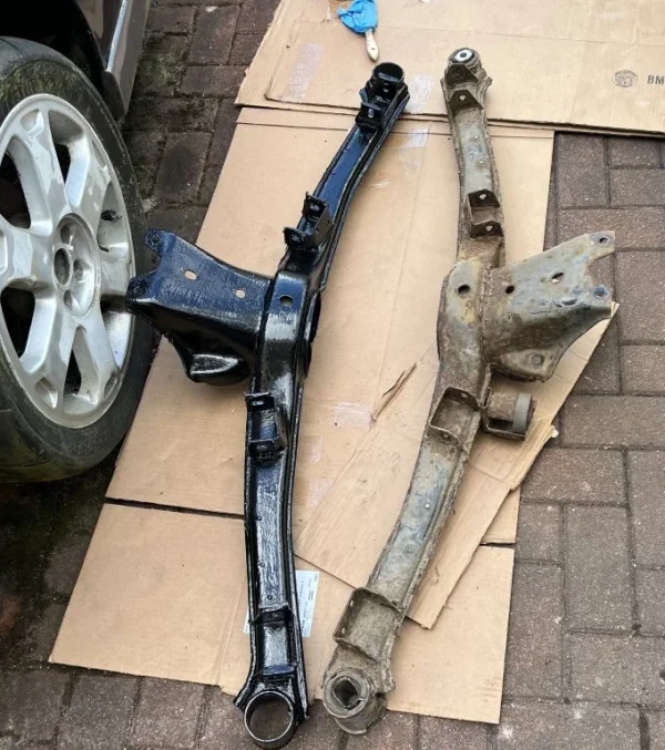

Only managed a couple of hours, got the sills a first coat of Hammerite smooth .

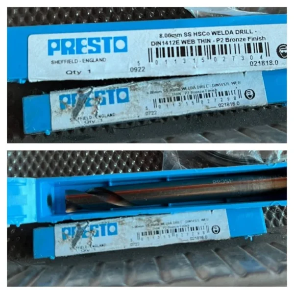

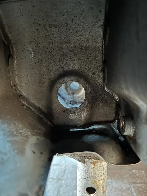

The two bolts on the left side came out with an extractor and masses of hammering. The one on the right, nearest the fuel tank, no chance. Tried different extractors, they just planed the damn thing smooth. Battering alternatives into the Center did nothing. I eventually thought F it, I have a welder. Took a 12mm nut, drilled it to 14mm, turned the gas up to the redline, the amps up and the speed down. Lined up 2 fire extinguishers and went for it. With the torch right over it, complete guesswork. Worked perfectly, came straight out with next to no effort.
The two big nuts needed a 5 foot bar, which was entertaining.
Pitch black by then, I’ll release the diff mount in the morning. I’m having a beer.

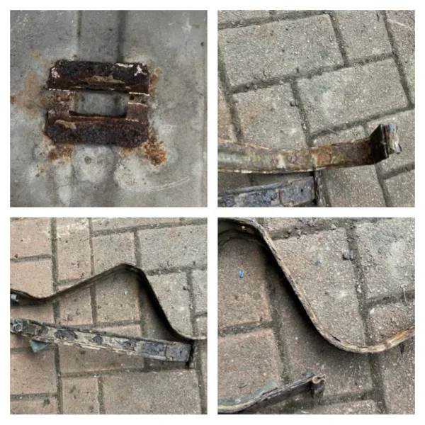

Dropped the tank. The decision on whether to replace the bracket was taken for me, it was fused to the strap and it snapped. Still available from BMW but I don’t have time to wait, so I’ll just make one. The straps are an easy bend from 3mm steel strip.

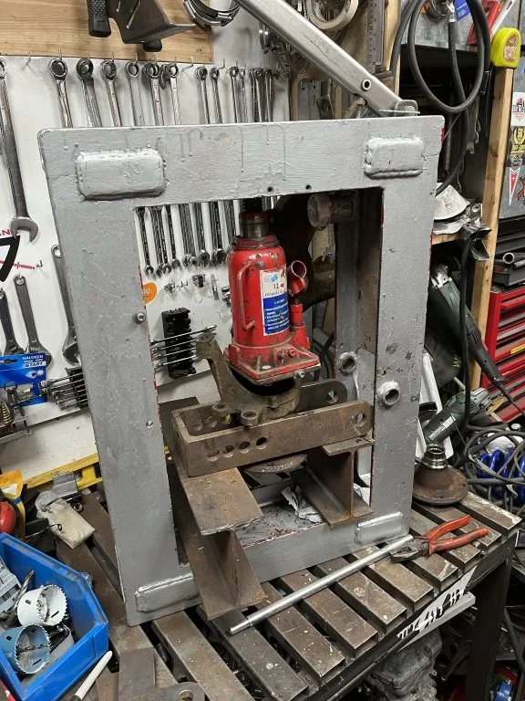

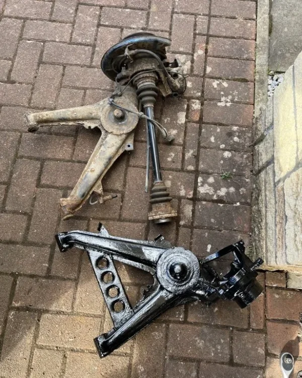

Rain has stopped play, so resorted to doing bushes and bearings. This thing is a homemade press, 2 sizes, depending on which way round I use it, hydraulic caliper actuator, metal bender and tube bender. All in one. Though I haven’t bent any tube with it, yet.
Mad, but it works. Pressed both the hub and bearing out in about 5 mins.

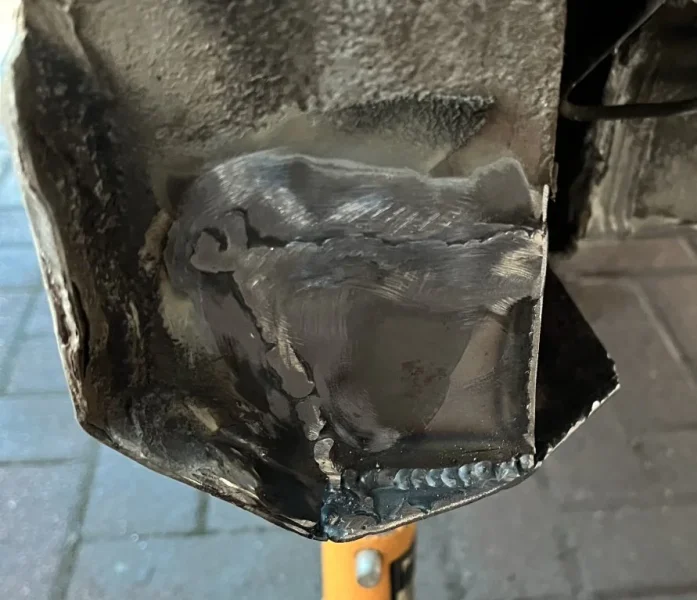

Welding in the rain is great, not.
If you’re going to buy spot weld cutters, don’t buy cheap, they’re junk and don’t last, get cobalt ones like these, last for years.

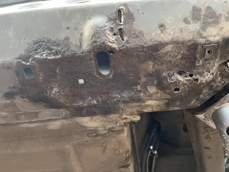

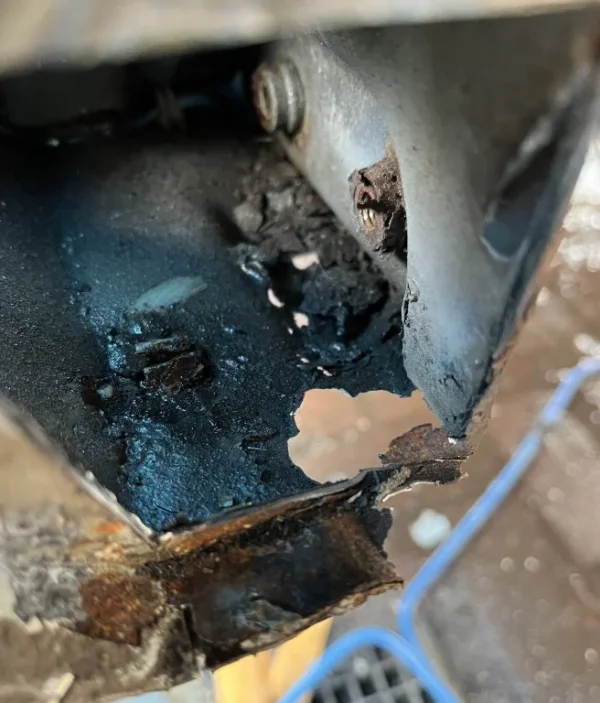

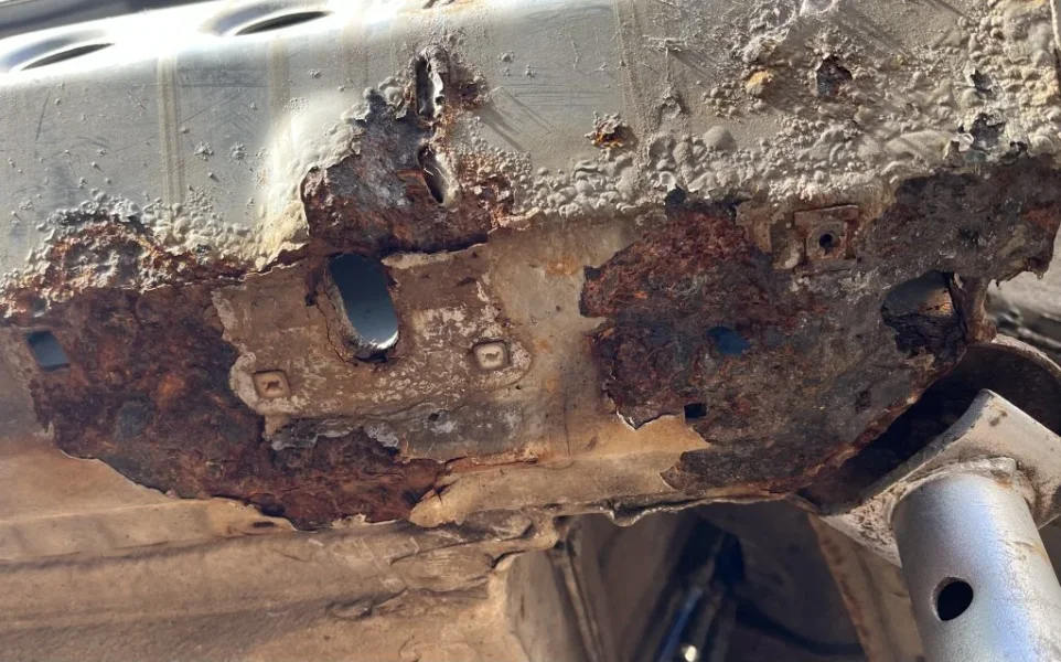

Peeking through the little hole in the inner wing and the grommet hole, things didn’t look great, so, I cut a section out a good 50mm above the grommet to get drill access.
Eww, not looking good.
Chopped some more out, attacked with some brake cleaner and a wire brush.

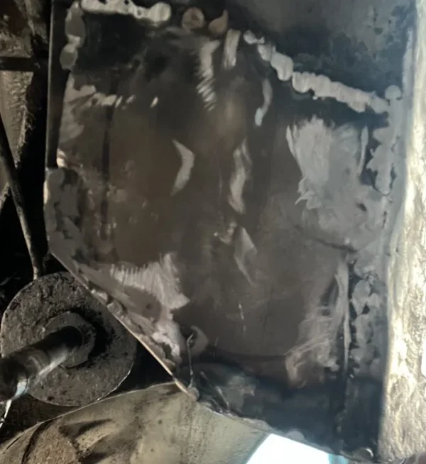

4DDF104C-E46A-4DDE-A891-7C4E952E6600.jpegThat’s a lot better.
The inner wing is 1mm, or 18 gauge for our American friends, the sill 2mm, 14 gauge.
It would have been a lot easier if I could have gotten that bloody pin out, but it’s solid. The only spare socket I could butcher into a tool is 12 point, and it rounded it when I put a big bar on it.
My hammer forming skills are rubbish, especially 2 or 3 mm. I have gotten the drain in, and most of the profile of the sill, but it’s meh, I’m glad it won’t be seen.
The inner wing is neat though, won’t be visible once underseal goes on.

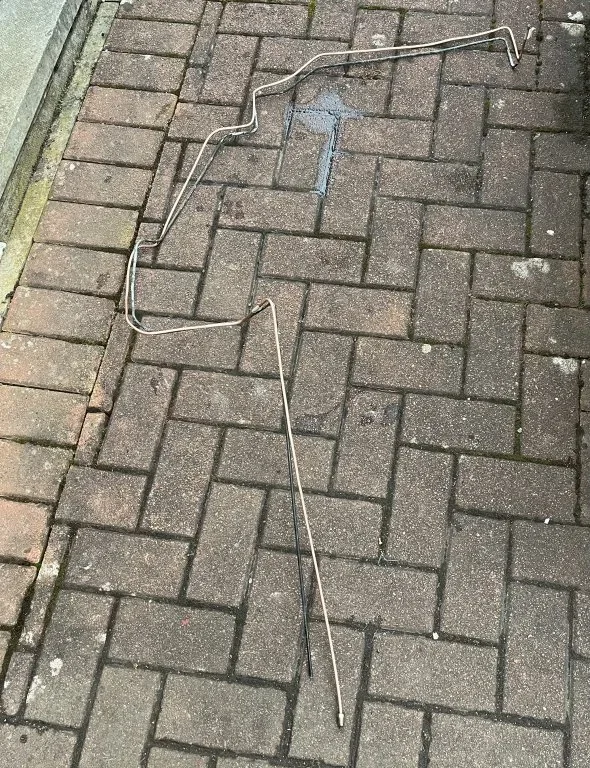

Some folks can take a straight piece of copper brake pipe, correct length, bend it directly on the car, and make it look as if it came from the factory.
Not me, I don’t possess those skills, I have to spend ages bending it beside the steel pipe, then adjust it to the car. And after all that, it still looks like a blind monkey fitted it.
