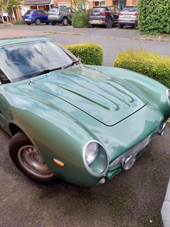

The car in the picture, like most 'rebodies', has a wooden steering wheel with no airbags so stronger seats is the least of anyone's worries IMO.
I cut the headrests off my MGB seats, have ditched the airbags, cut off the roll-over hoops and have a fixed wooden steering wheel.
Modern safety is not my priority. Replicating a 1960s car, as near as is possible, is.
it looks to have a roof too 😉. But the OP is talking about another Z3 they have just bought, hence my comment about"...depending on what your plans are...". If Geoff is keeping it as a regular Z3 but just changing the seats, then knowing they are part of the roll-over protection may be relevant information.

The rebodies with roofs have a roll cage, although it would probably just fold like a banana and pin you into the burning wreckage :) .
Are they roll cages, or just a frame to stop the plastic roof flopping about?

Did you intend to post a picture or link?
Now I see it.
