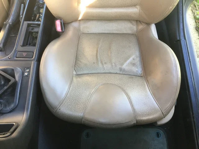

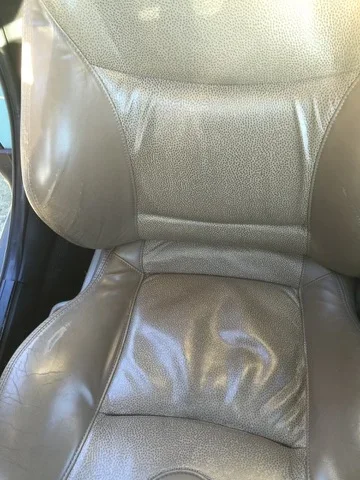

The foam parts are availible from bm still but if your leather has gone too a doner set or a full retrim is the best way in my opinion. If your handy do what i did and buy sports seats and renovate them yourself it amazing what you can achieve.
From this....
To this....
For less than £50
Did you use scuff master for your dye and treatment?
Just purchased some dye for bolster touch up and gear knob re furb :thumbsup:
I was in two minds weather to purchase the blow diffuser, but the sponge method seemed to do the trick. Covers any grinning dark patches very well, but I don't seem to have found a way hiding any creasing, I suppose this is just a chareteristic of leather??
You can get a really fine filler that you can fill them with i did some of my really heavy ones but its just natural.
You can feed it too that makes it hydrate and that helps too.
