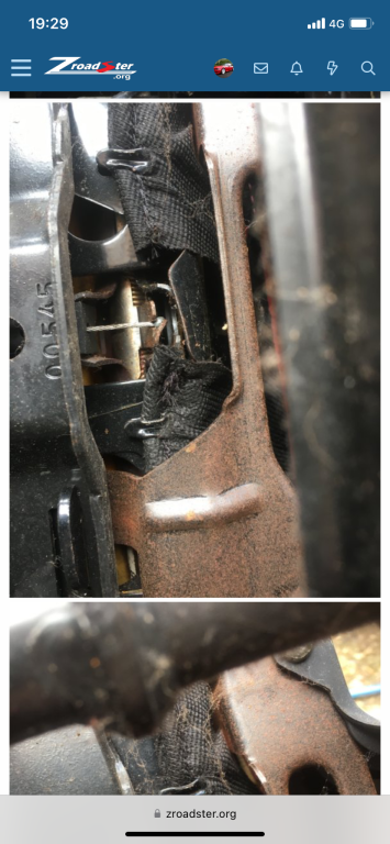

This might help, this is where the nipple attaches

Yes, if it’s not reclining it’s often the tab in the pics above has bent. That’s usually because the water under the seats has corroded the tab, or the tube it’s attached to. Applying oil to make sure the mechanism rotates freely, and maybe bending the tab back into position cures it. Both of my seats had that problem. It’s important to not the bend the little tab too far, you need some slack in the cable, otherwise the seat recline mechanism doesn’t latch properly and the back will recline just by giving it a good shove.
If what I’ve scrawled isn’t obvious, let me know, I’m sure I have pics.

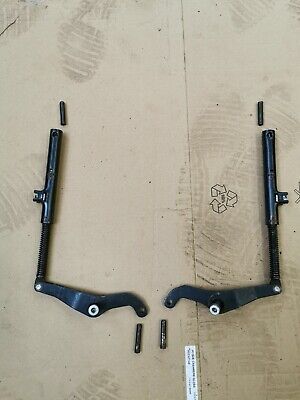

I can’t find the pics, this is on eBay:
The tube jams on the spring. It’s all held by the pin. Mine was so jammed on one seat, I had to knock the pin out and smack the tube with a hammer to free it. The other I held the tab open with vice grips, added oil and moved the back repeatedly to loosen it up.
