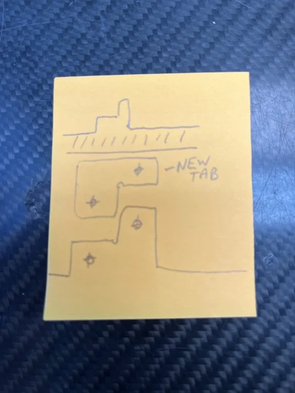

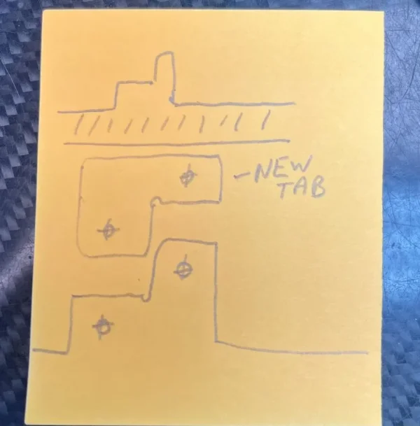

Thanks Iain. I don't (yet) weld. But that idea of a bolted tab sounds good. Don't suppose you could draw the idea for me . As not exactly sure what you mean. Thanks

Sure, kind of like this
couple of 3 or 4 mm holes and a small piece of steel. I wouldn’t go too big with the holes. Toolstation do cobalt drills in both 3 and 4 mm and small machine screws/nuts in both those sizes, bought some recently, I think the 4mm £1.50 for 20 😂
I would definitely go for the cobalt drill bit, so much sharper than hss.

Thanks Iain I used a single hole a washer and one small nut and bolt. Works fine thanks for the idea
