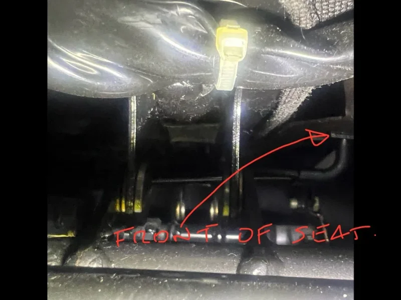

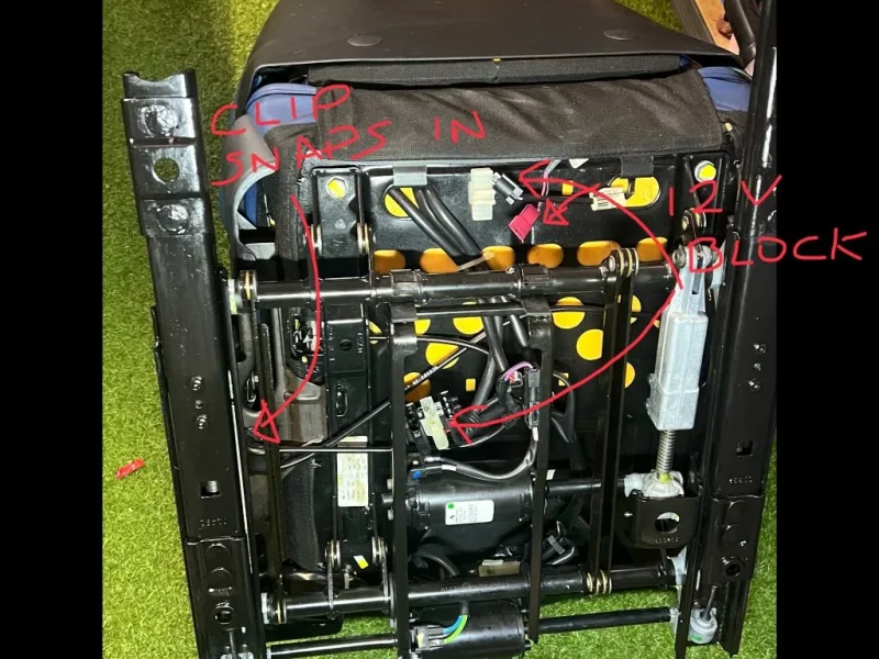

Mine had this issue with the manual recline lever , I removed the seat to find the bracket had popped out from the frame.
This just clips snaps back into the frame without actually removing the seat,:rolleyes: if that is the problem .
Mine was the passenger side UK (Driver if state side usa )
If removing seat just disconnect the battery to save airbag faults .

Interesting. Thank you. I will try to take a look (if I can contort myself into being able to see from the floor)
