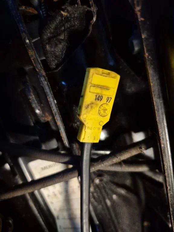

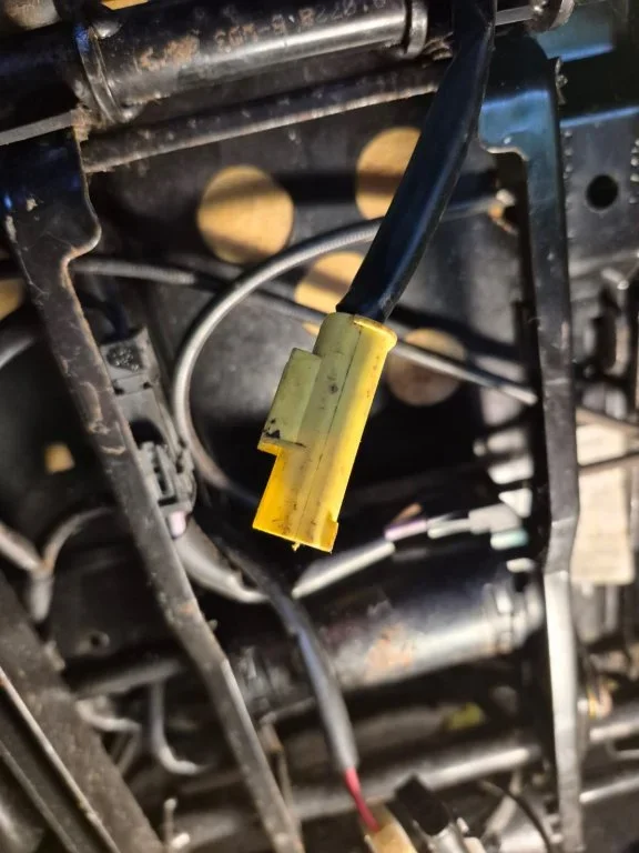

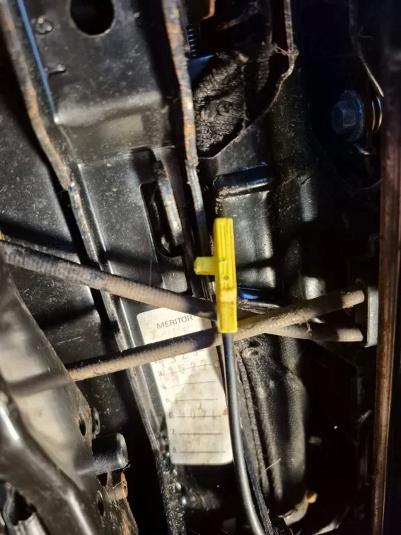

Hi yes this is still. Connected. But where does the other end connect to, I dont appear to have anything it fits?
The other end goes into the large connector from the seat loom, which in turn connects to the connector from the car from under the carpet.
The large connector on the seat has three smaller connectors 'plugged' into it; that one, the power for the seat motors and the heating connector.
If that makes sense!

I've searched high and low and can't see where it connects. Do you have a picture?
