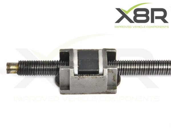

I had the same problem! It took me hours of trial and error before I found out what the problem was... I had tightened the screws to tight on the metal thingy that holds the bushings (see picture). Loosen the screws and problem solved! Hope it works for you as well. Cheers.

The above seems a resonable answer as too tight would bind the mechanism but did you slacken off these to resolve the first issue ?

Those two screws are torque screws that attach the "metal thingy" to the slider. As the screw bar turns, the "metal thingy" makes the rail slide (I think?). Forgive me, but how would loosening them help please? Wouldn't it just put additional slack in the mechanism and perhaps rattle?
That said, I will try your suggestion next week and I am really grateful for it. I managed to get the passenger seat working after 3 attempts but haven't a clue how I "fixed it" though. Have just put the car back together minus the two rear bolts and the seat feels firm - at least the new bushes are working, the originals had all but disappeared and there must have been half an inch of movement.
Thanks again zingoelBurro
Ianmc, no rattle or slack, just smooth rattle free glidning sport seats. My amateyr guess would be if you tighten the screws to tight you "bend" the screw bar and the mechanism gets stuck.
Sir, you are a gentleman and a scholar!!!! Just loosened the torque 4 x bolts above and it works fine, problem solved. I am really grateful for the steer and owe you at least a few beers. Sanity restored, thanks again.:)
