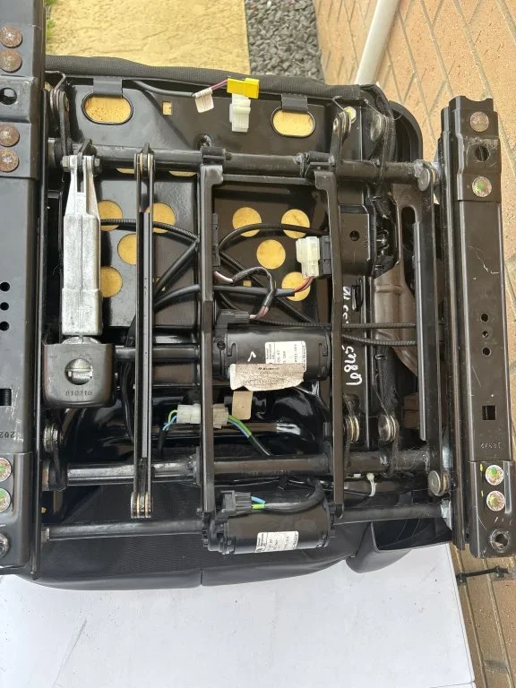

I have followed videos and cannot get to the bushes!
I have the seat out and the two torc screws out but the rail will not go forward far enough to remove the larger torc bolt to move the rod with the bushing rod part.
I replaced mine, nothing left to replace so seat slid alarmingly forwards and backwards when first purchased; there was a very handy how-to somewhere about that told me how to move the seats to access bolts but also how to centralise the rails when refitting. The biggest worry is damaging the cables underneath.
