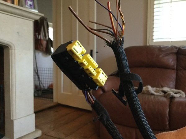

Low rider - thanks for your reply - I have the seats out of both cars so have checked all plugs and am aware of the adapter.
as I have the plugs from the donor car, (see pic 1 below - this one is drivers side)
all I am asking is for some kind person with easy access to a bmw adaptor to either :
EITHER
take pics of each plug at the car end
OR
DRAW a simple picture showing each of the 5 plugs at the car end of the adapter cable depicting what colour wire goes to which pin
I’m aware that the drivers and passenger yellow plugs carry different colour wires but as long as I get one done I can work out the other.
See pic 2 below
ANY HELP MUCH APPRECIATED

Just so it makes things simpler - out of the 5 car end connectors there on the picture you will have to just wire the big white connector if you don't have the heated seats and just one of the other smaller ones for the belt pre-tensioner on the side of the seat. If you have heated seats you will also have to wire the other big black connector. If you have passenger side airbag then add another of the small ones but just for the passenger side seat occupancy sensor. If you happened to have a japanese / USA import I think that's what he 5th connector is for as they had also seat-belt clasp sensors to check if you had fastened your seatbelt.
