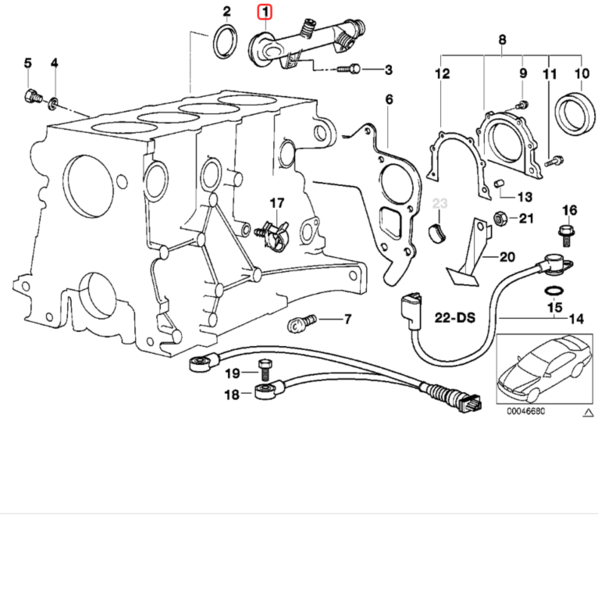

I recently changed all of the plastic/rubber tubes/connectors for the cooling system and it appears that I have a leak. I manually pressurised the system today and it's unable to hold at 1bar for long. I managed to find 3 different connectors that must have been loose and tightened them pretty easily. Now it looks like part 1 from this diagram is leaking (https://www.realoem.com/bmw/enUS/showparts?id=CH73-USA-05-1996-Z3-BMW-Z3_19&diagId=11_1558). I remember it being a pain to insert in the first place. Does anyone have any good ways to seal it without having to remove the entire intake manifold again?
PS: In all my filling/bleeding I somehow managed to snap the bleeding screw in the radiator (https://www.realoem.com/bmw/enUS/pa...3_19&mg=17&sg=05&diagId=17_0089&q=17111712788). I was able to get it out, but it seems strange that it broke and I'm a little worried I have damaged the seal. Has anyone seen that break before?
