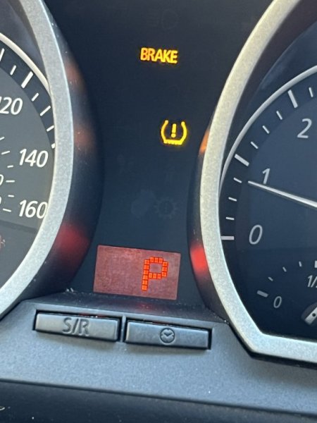

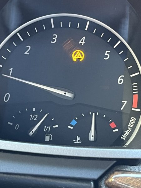

There is nothing to service, as such on the steering but this is where your mechanic should start. No parts cost involved and really no more than 1 hour labor.
ps. A new battery needs to registered to the car after 2002, which could also put out those warning lights on the dash.
