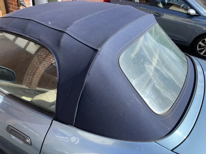

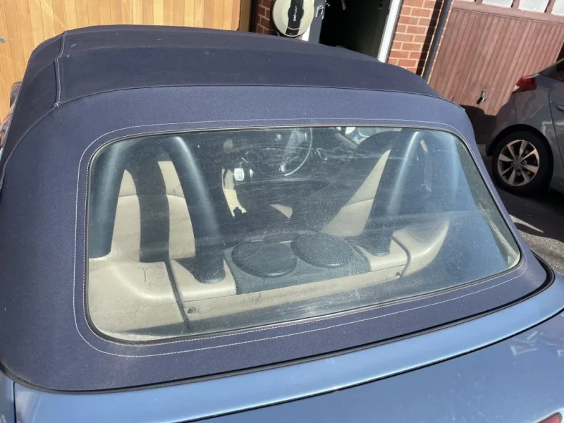

I’ve got a project 1998 BMW Z3 98S, and back in 2010, someone spent £800 on a high-quality blue soft top from Ballam & Thurlow. The roof still seems very well made, but it has started to sag.
Is there a way to tighten or repair it, or am I better off replacing the whole thing? Has anyone had success fixing a sagging Z3 roof?
Also, are all rear windows interchangeable? I know some Z3s have zip-in rear windows—can they be swapped easily, or does it depend on the type of roof?

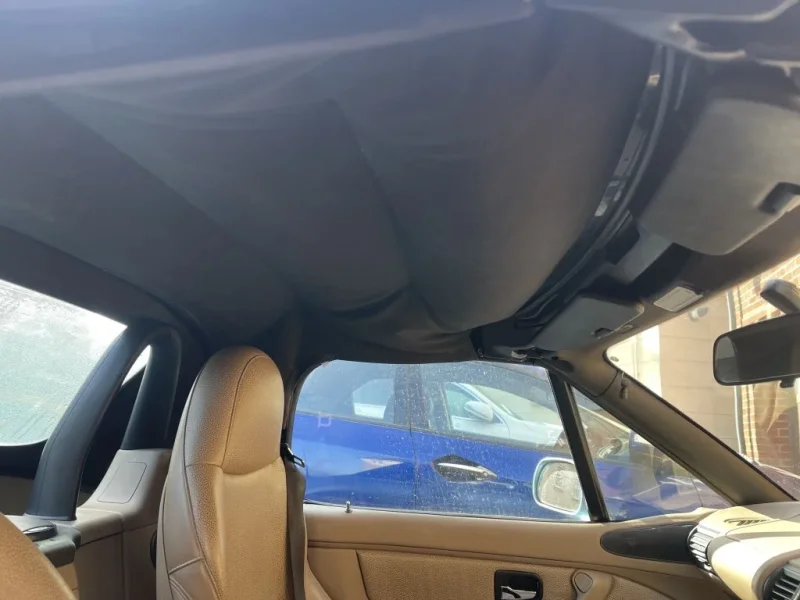

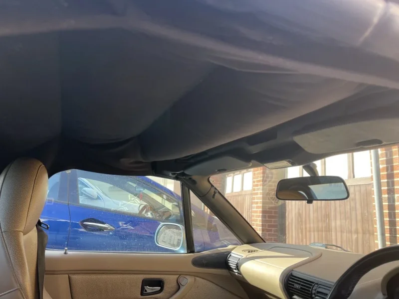

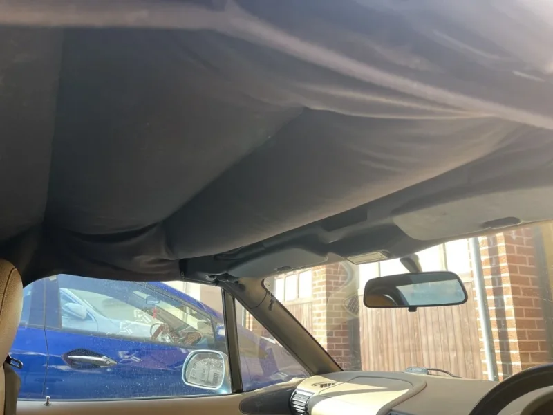

It looks like it's the interior lining that's sagging. The actual roof look ok.
My car doesn't have a lining but, if I'm not mistaken, the lining can be removed/replaced maybe even fixed without removing/changing the whole roof.

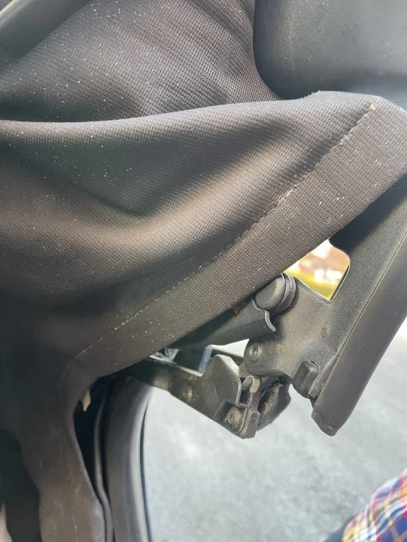

Yes that’s the lining. With the roof down check to see if these bits have snapped or broken. They keep it taut. The nylon string bit usually gives up.

Doesn’t look like a factory headliner to me, not the same material and too much of it. When one of my tensioners broke I barely noticed any slack in the lining just a little spring hanging down.

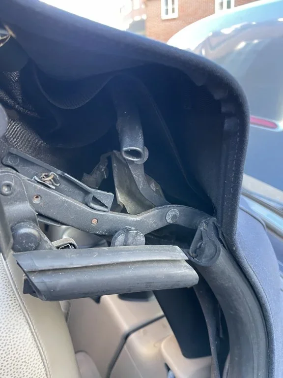

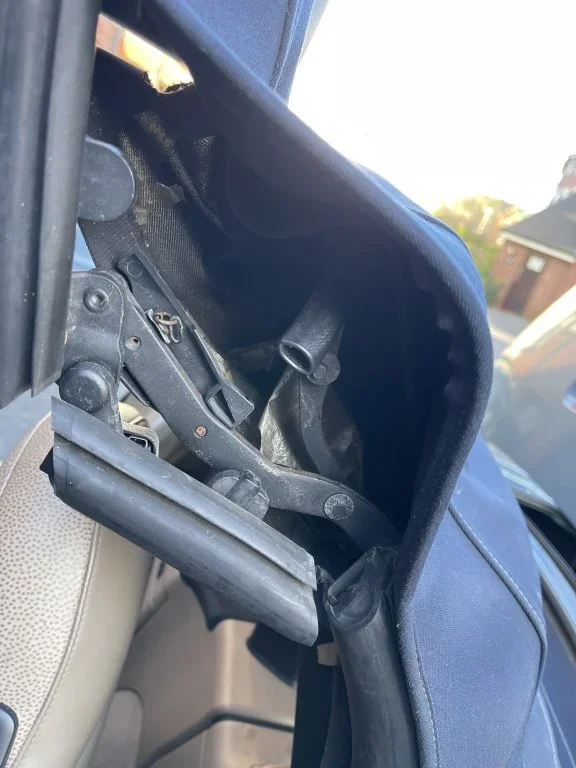

This is where your tensioner should be attached. Also that tube looking thing shouldn’t be like that
Wonder if this may help
