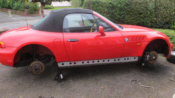

There are a number of places you can put them - it depends on what job you are doing and access required. You need an equal distribution and spread of load. I use suspension arm points for most jobs - couple of examples in attached pics. You don't need anti-slip on top but may need some load plates underneath if the ground surface is not sound.
If you have the wheels off and want `belt and braces' - then slide the wheels under the sills. Ok if the car falls you will damage the wheels but better than your head!
