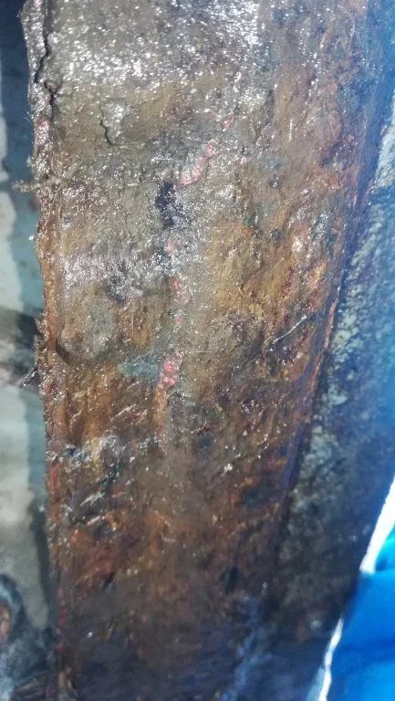

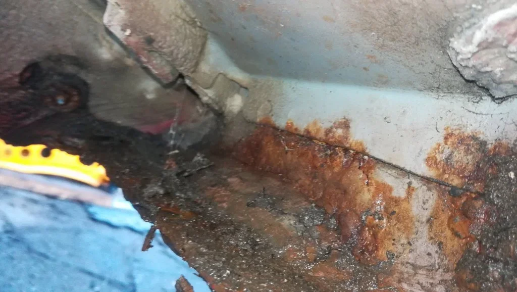

All Bilt Hamber stuff is amazing if slightly pricey. If you have the time and patience, BH Deox Gel can dissolve every last bit of rust and give a perfectly prepared surface for paint. The cleaned sill below took weeks to achieve, but looks as good now as when I did it two years ago.
Now that's impressive! I will definitely look into that. I can see the main problem being not having a dry environment / or garage for doing this kind of work. Will have to find one temporarily. Thanks again.
It's not looking so good though 🤔

I wouldn't get too disheartened just yet. It's really thick metal round there and cleans up surprisingly well. Best thing would be to attack the loose surface with an angle grinder/drill to see what's left. I found a cheap finger sander from Amazon was really useful for those awkward areas behind the wheel arch.
Thanks I did clean it of but the rain etc. It's not as bad as it look I think. Then I slapped some grease over it all. When weather improves will be prepared with chemical treatment and what ever I go with. She'll by rite 😉Thank for your reply
