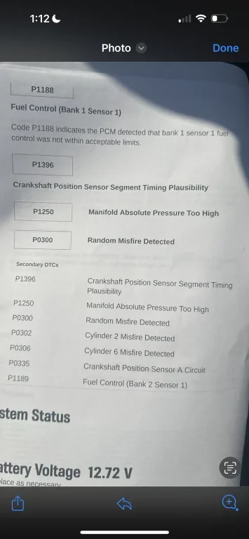

Have you put a code reader over it ?...

Yes I put the code reader over it and says the I need to replace the Maf sensor. But I think the new one I got does not work, because when I unplug the maf sensor the car still keeps running

What sort of code reader are you using ?... I suspect you still have a vac leak.. Even a cheap MAF should last for a day or two, :whistle:, more info will help the members that know more than I do, help in diagnosing the issue or issues..

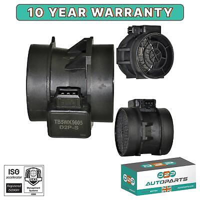

It's the unit adjacent to the air filter between it and the throttle body. Just pull the plug and the engine should run.
Check out the link to see what it looks like. There are hose clips either side of the MAF body so it's really easy to swap out.
Indeed. Probably the easiest access part of any BMW I have ever seen (certainly on the M54).

Only use oem Mafs either Bosch or Seimens brands, cheap ones rarely work or last long, been there and done that. My symptoms were poor power, it was like the car was being held back. Cheap Maf didn't fix it but oem from BMW at extortionate price cured it immediately.
