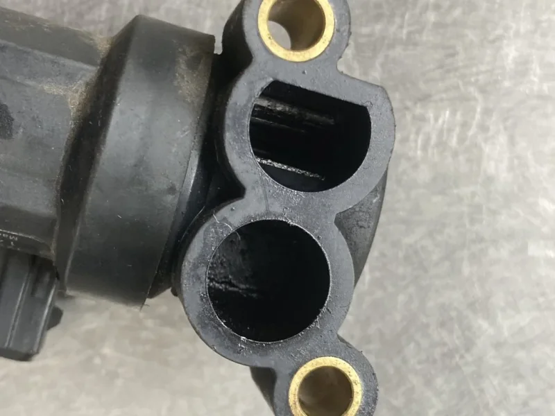

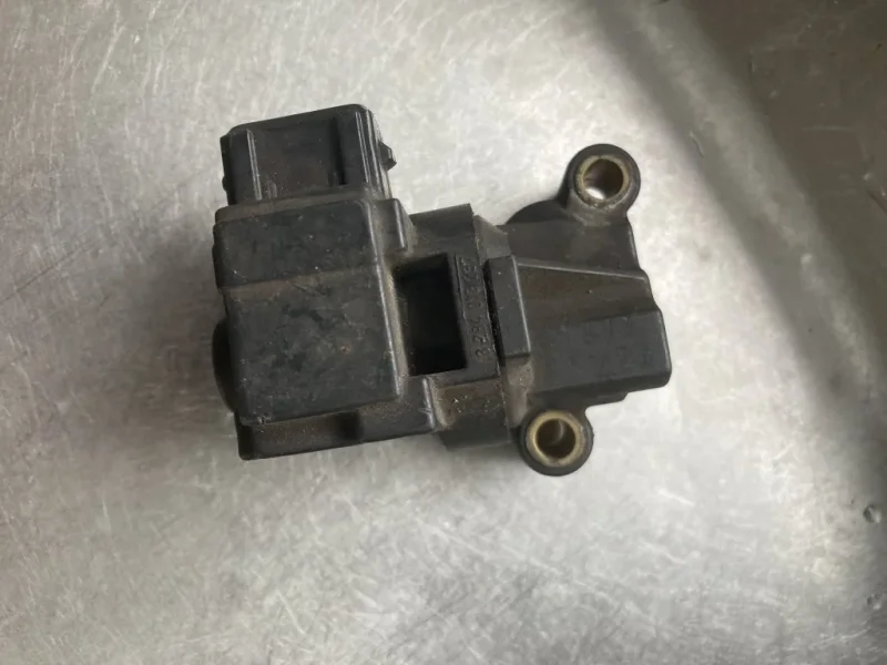

That problem can also be the idle control solenoid on the front of the inlet manifold - this little b*****d.

@Andyboy makes a good point regarding the idle control valve, whip it off and give it a good clean with carb cleaner spray so the internal flap moves freely when its given a shake. The do get gummed up and stick, easy enough to take it off but take care with the gasket when taking it off.

There is a video in youtube about the idle valve and he pries it open. Do not do this.
He clearly destroys the valve.
Just clean with carb spray and blow with air.
but whatever you do, do not open it. (235€ for a new one I paid and I still feel an idiot for doing this although I knew it was wrong).
