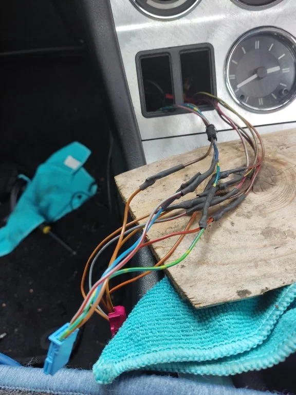

There's very old threads about this on "other" bm forum but couldn't find a definitive answer on this one. There was some confusion on the other forum because people answering were talking about a digital clock with trip computer? Average fuel consumption etc?
My PreFacelift (unless I'm mistaken) just has a very basic digital clock. Just tells the time. So no trip computer or anything.
I want to replace that with the round clock from facelift. The one that sits in the middle below the heater controls.
I've got the plastic panel, with round clock. I haven't tried anything yet but, if I'm not mistaken, the plug/connectors are different.
One of the posts I read somewhere talked about cutting and joining wires. But another post said that the plugs for both types of clock are under the centre console.
Anyone know if both types of wiring/plug are there?
Thanks
Hi I upgraded my centre to a round clock face lift. I'll try and find some photos. From memory the connectors where diffent but the wire colours where the same and I got it all working fine. Basically just joined similar wires together!
