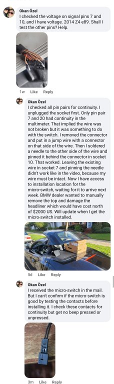

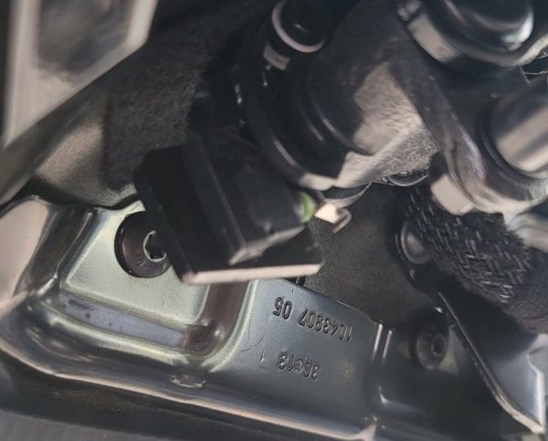

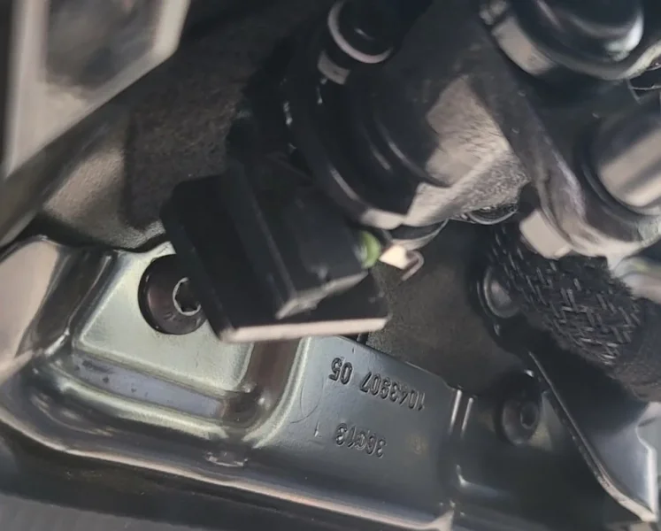

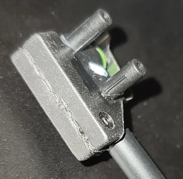

My multimeter did not show any continuity across the pins for the new micro switch, but when I checked ohms, it shows 0.5 kohm not pressed and 2.8 kohm while pressed. I assume the new switch is good. I will replace the old one. Micro switch has 2 plastic rods for attachment to panel, I assume I have to melt them to bond to the holding plate but when I get the old micro switch out I might have a better idea how the switch had been attached to the plastic plate.

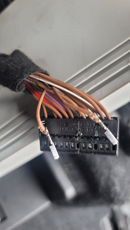

To all others with similiar problems:
Don't touch these switches in the roof shell: they hardly ever fail. As re-mounting ist not so simple, avoid touching it.
Care about the broken and/or shortened wires in the upper bow behind the rear roof shell.
