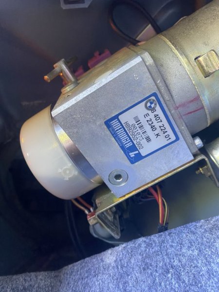

My roof has an intermittent fault when sometimes it doesn’t operate correctly most of the time it’s fine some of the time it only works with the engine running I hav taken a pic of the reservoir should it be topped up if so what fluid should it be

My reservoir has a very similar amount of fluid in it (maybe even a tad less)
So either both of ours are fine or both need topping up!

The microswitch in the roof and the brake light switch are a known problem. One is much easier to check than the other ;)

Also the cable from the microswitch can break with age as if routes through the roof frame. Very unlikely to be the motor imo
