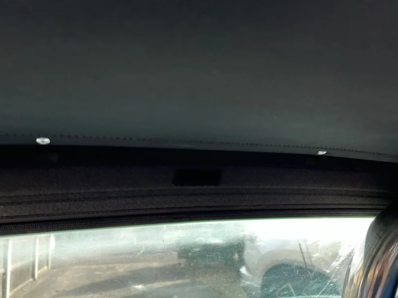

Hi All,
my roof lining has come off the metal frame towards the back. Both the rail on the liner and the metal frame appear to have holes that would suggest they should be screwed together.
Is this correct? If so anyone know the type of screws I need to reinstate others I guess strong double sided tape
TIA Clive

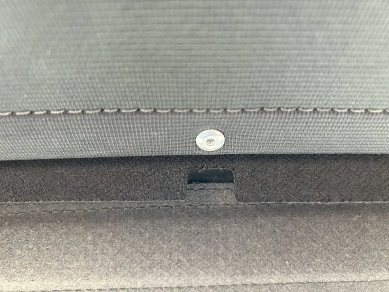

So I finally got around to fixing my headlining back up. Bit of trial and error but I found 4x12mm rivets works best
