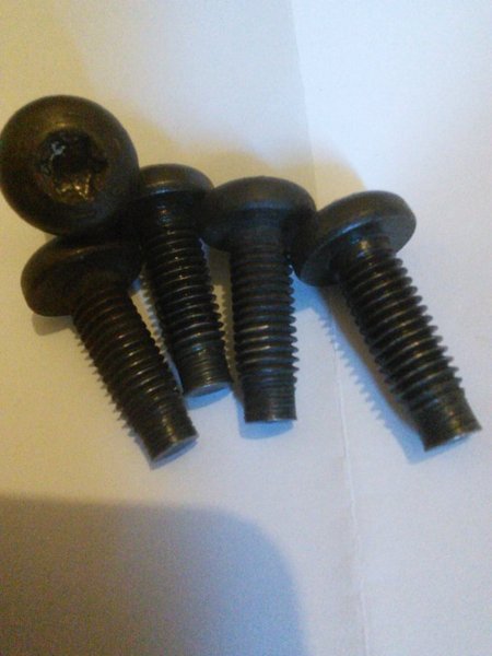

All of the 5 bolts that have come out ok look strange..like the last 4 or 5 threads are stripped... Are they supposed to look like this? IMG_20170513_192842.webp
Sounds like the threaded insert its screwed in to has broken away if it's just spinning around. Can you get a screw driver head underneath the torx bolt and lever it up slightly as you turn it?
So you think the thread in the turret rather than the bolt? I've given up for the day Gaz, but if I can get some leverage under it then I'll give it a go tomorrow.
It is a tight space, the bolts have quite a big head on them, you need a forked tool to hook behind the head of the bolt, you can pull on this whilst unscrewing the bolt, if it is the bolt that has stripped then it should come out.
