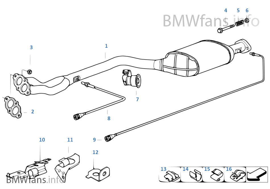

You ideally need to get the codes read, it will indicate where the problem lies, I think it will probably be the cam sensor, not a difficult job but takes a bit of time, the car only has one lambda sensor, if it has done more than 100k miles it is worth changing anyway.
