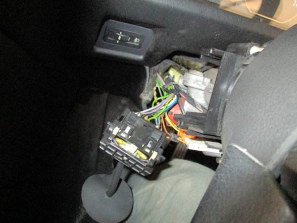

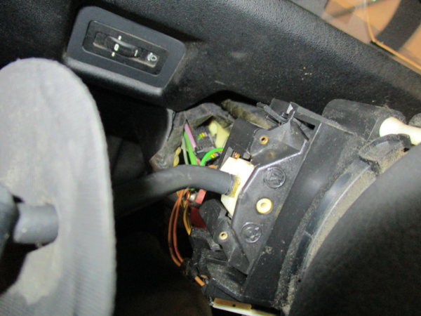

Sure I've done this before without having to remove the steering wheel.
To get to the wiring you might need to remove the trim panel below the steering wheel. 6 screws - 2 against the centre console, 3 to hold against the upper dash and 1 on the side where you open the door (need to use a short handled screwdriver for this). Also remove the lower trim panel where your feet go, there are 2 plastic quarter turn flat screws that you need to loosen.
Need to remove the steering wheel cowling - 1 plastic cross head screw underneath and one on top, then pull the cowling apart. There are retaining clips holding the stalk in place, just push them apart and then the stalk will come free. Then follow the wiring down the steering column to unplug the connector.

It's done! The last minor fault in my RHD Z3 is fixed. I have been putting up with this for a couple of years now. I thought I would need to remove the steering wheel and the airbag scared me. I knew I was looking at 4 or 5 hundred at the dealer..........sleepless nights.......but all along I thought it might be just a dirty contact. Turns out getting at the switch was easy as pie, once I committed to the job. Once the steering column shroud was out of the way, the whole switch just slid out. I was happy to see that the mechanism was open, so I soaked the s*** out of it with ether. I waited an hour for the fumes to dissipate, then I hooked up the battery, turned on the key, and both signals work perfectly. Calloo, callay, oh frabjus day!
