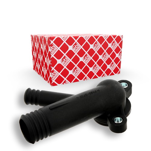

This, the flange on the rear of the head:
Becomes brittle with age, eventually cracks and causes a mysterious water leak.
If you are replacing it, don’t touch it until you have the replacement to hand. That way you can compare what you remove, not unknown for bits to remain in the head. You can’t see them, so using a phone in selfie mode to check you have everything out is a good move.
Use a good quality socket on the thermostat bolts, surface drive if possible, 10mm. Give a smack with a hammer on the end of the socket, helps to break any corrosion lock before you attempt to twist it.
