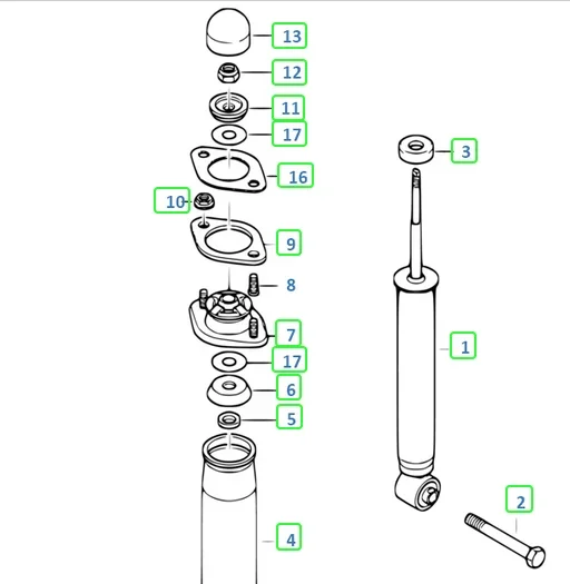

It's easy enough. In the boot* slacken the top nut first, remove the two 13mm nuts and with the rear jacked up, push the damper (shock absorber) down and replace the top mount with a new one. The wheel can stay on.
Bear in mind that there is/should be a big washer under the top mount to spread the load. Number 6 in the pic. Many have rusted away and without it the damper will just punch straight through the top mount.

Andyboy
Jun 2, 2019
119
SHEFFIELD
Do it with the hood up (closed), seat powered forward.
The top mount can't be accessed from the boot (I was thinking E36) but from under the grey carpet behind the seats.

Thanks a lot for the detailed explanation and the image!!! Sounds very do-able so perhaps I will give it a try now in April 😁
