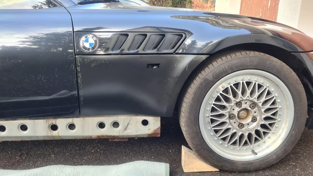

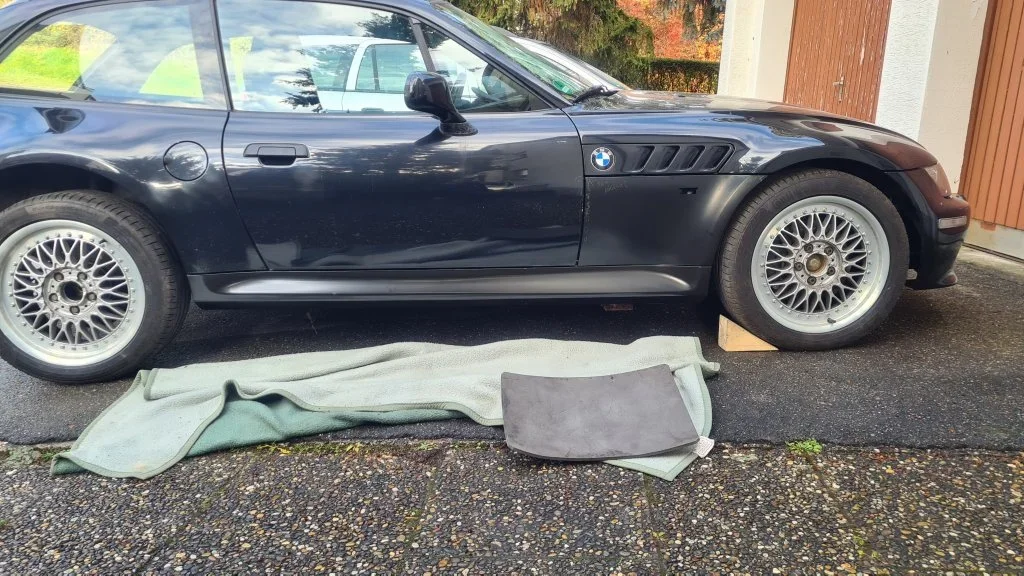

Hi there,
I decided to replace the driver side wing when I was doing my sills and was quoted around £250+ for the OEM part. As it's really just a decorative cover and has no structural or mechanical importance I decided to try a third-party wing. I used Autodoc and went with the HD brand item 1250006 as seen in your link as it stated it was zinc-coated. I think including delivery it cost about £75 but that was nearly 2 years ago.
The wing seemed to be good quality but did need a bit of fettling to get it to fit properly. The folded edge at the door side needed hammered down a bit so it wouldn't snag on the door when it opened and a little bit of Dremel with a grinding wheel to tidy up some edges. I used the original wing as a kind of template and tried to match it. It probably only took about half an hour to sort out and once painted you'd never know the difference. From my experience I'd certainly recommend it as long as you're happy to do a little adjusting to get a good fit.

That’s fine but make sure the body shop has sorted the fitting before they paint them. You don’t want to be hitting them with a hammer once they’re all shiny!!!!
