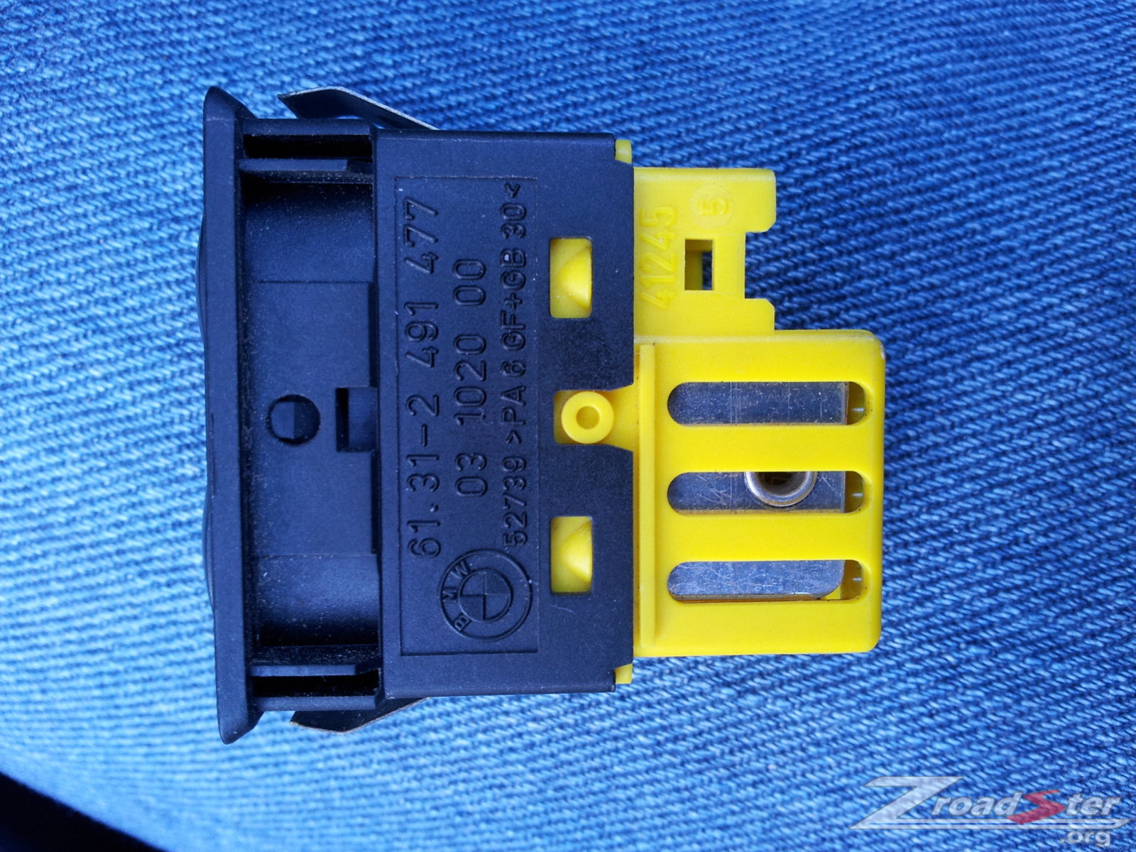

    This is a picture of a facelift switch, and you can see the two metal tangs which need to be pushed in to allow the switch to come through the hole. Without those being compressed then it's going to be impossible to remove the switch.
    I've just checked and it's the same principle on the pre-facelift switches as well without damaging something else!
